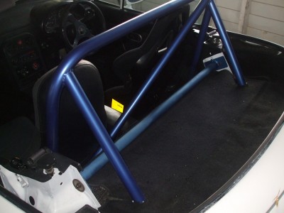

Just a quick question, the trackday I'm going to, do you guys reckon this bar will be fine? Its a bolt-in bar too.. (sorry I know I'm whoring pictures all over the place, only way I can show you guys, last one, I promise)
Post by chris » Thu May 30, 2013 11:39 am
Nice pictures.
I will be honest, get a new bar. I'm sure they will let you on.. but that bar will not do jack.
Get a 4 point bar. I think Kieran (Furai) has had one made up. Talk to him =]

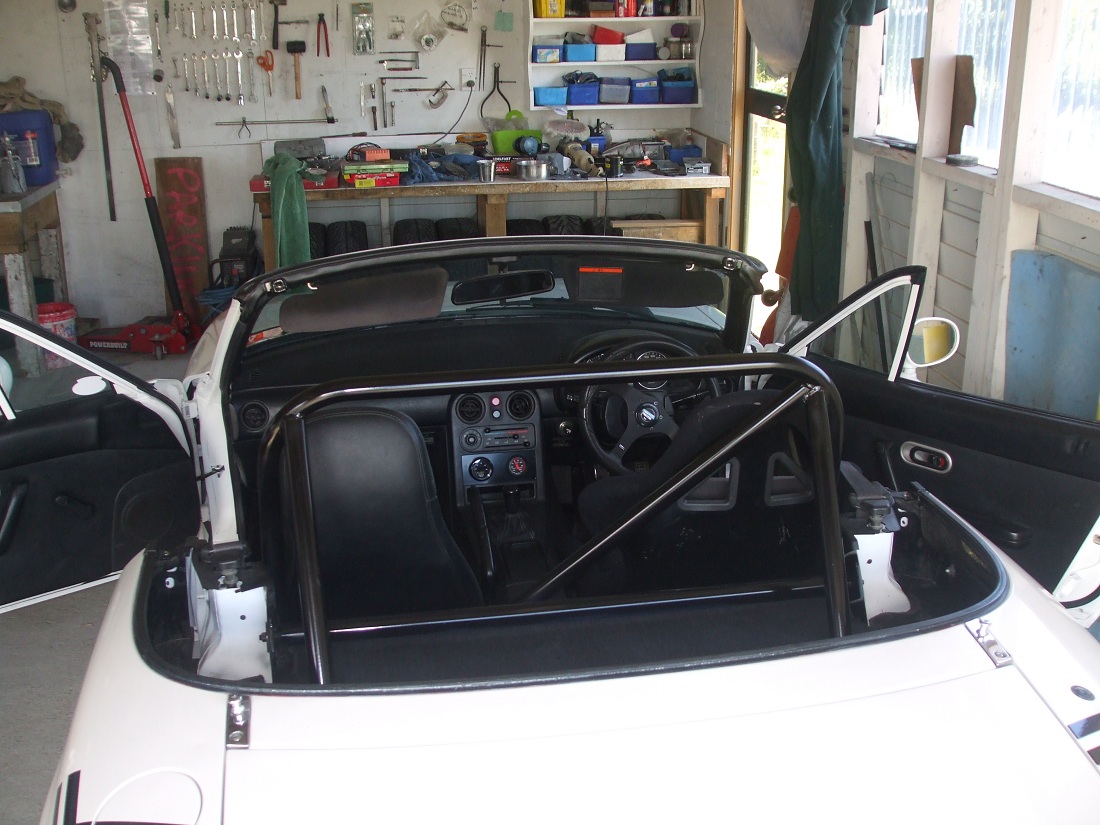

Post by Furai » Thu May 30, 2013 2:00 pm
You will have to have a talk to the track organisers. Some of those are actually pretty strong but personally I wouldnt trust it.
This is the one I got made up. Not super cheap though. 44mm MSNZ spec Rollbar. You can get a bolt in Cusco for about $700, this would be a similar price but shop around and get a solid quote. Mine was slightly cheaper because I did all the stripping of the interior and that.
Also this is welded in. Bolt in is for virgins as Bwarp would say.
Post by BRM » Thu May 30, 2013 6:43 pm
How verticle is the main hoop?
Why haven't you gone for any diagonals or horizontal?
Post by siren676 » Thu May 30, 2013 7:31 pm
because hes a tall lanky bastard and needs the seat back as far as possible :lol:
Post by CordedBowl » Thu May 30, 2013 7:34 pm
Furai's got a rollbar, rad! (I'll race ya~)
Your car is looking great Skilful :D
Post by BRM » Thu May 30, 2013 7:38 pm
siren676 wrote:because hes a tall lanky bastard and needs the seat back as far as possible :lol:
But, the hoop goes to the floor,
like a proper one should, and instantly that must restrict seat positioning.
But, his seat Is mounted to the floor, so that helps anyway..
I'm just about getting mine done too,
But it's getting diagonals and harness bar...
Post by Furai » Thu May 30, 2013 8:08 pm
Diagonals can be added later if wanted, I wasnt keen on the restriction to rear view to be honest.
Main loop is not vertical, has a slight outwards stance at the bottom.
Also Corded Bowl, Ill race ya :wink:

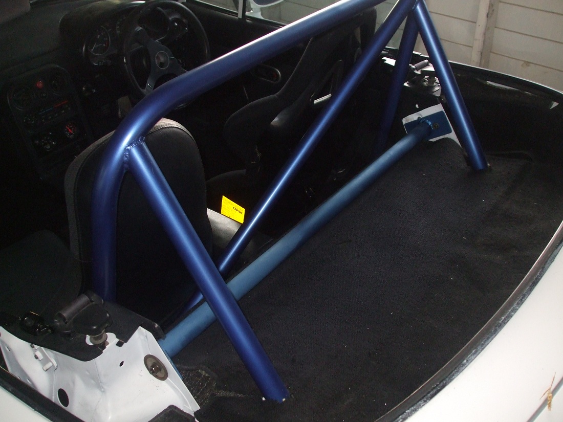

Post by WideOpenThrottle » Sat Jun 01, 2013 4:51 pm
Looks like mine without the Diagonal & harness bar.
When it was blue
Post by BRM » Sat Jun 01, 2013 5:54 pm
Ah cool
How much does it restrict seat travel..
Unless yours is on the floor...
