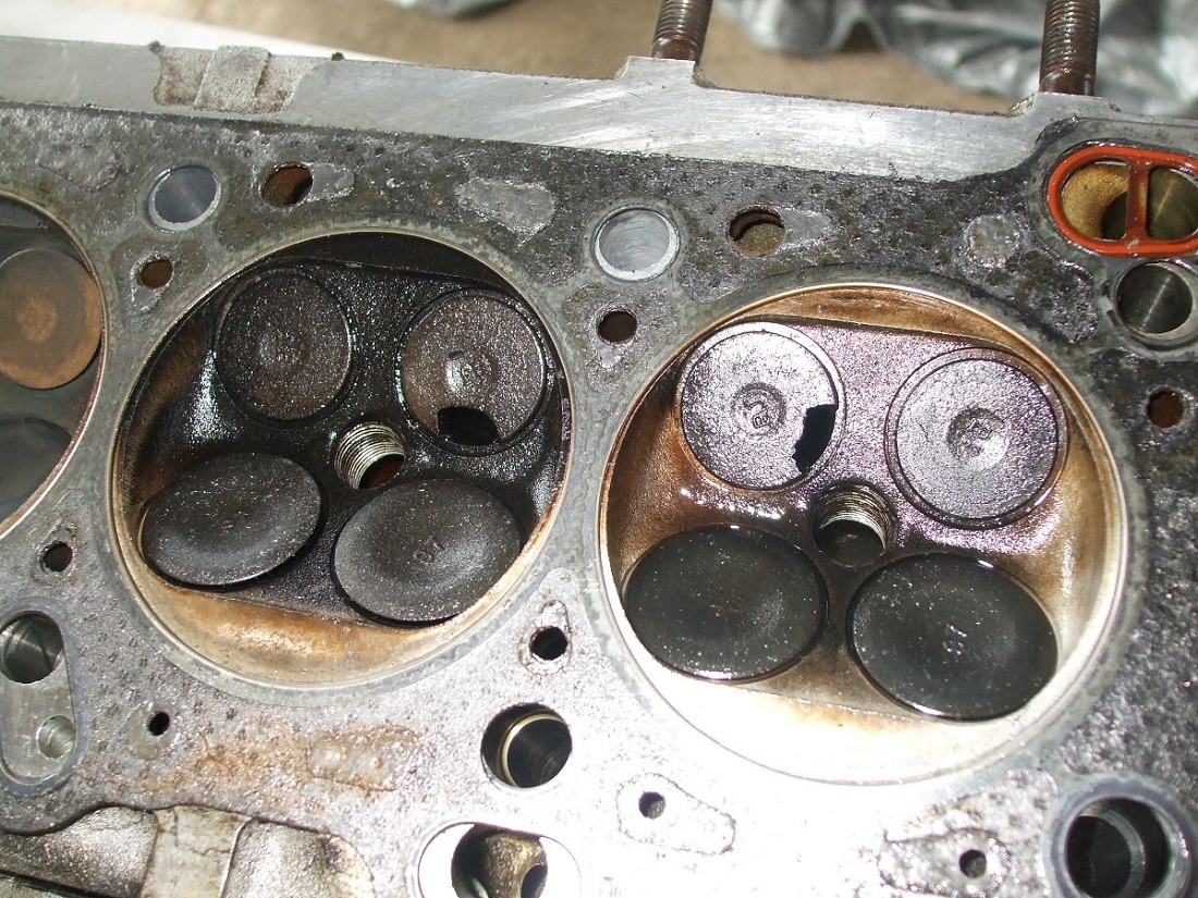

Nope. Took the head off tonight and it looks like something has got into No 3 cylinder. Small amount of damage to the chamber on 2 as well. There is still something embedded in the head on No 3 which is likely to be causing the tapping we could hear. The air filter is still intact so I can only assume something has dropped out of the inlet manifold. Will dig into that over the weekend to see what I can find.

Post by WideOpenThrottle » Fri May 17, 2013 8:05 am
That looks very much like what happened to mine at Puke! I had the same score marks down the cylinder walls too! Engine detonation from running too lean was suspected with my earlier turbo set-up!:D
Damage was to 3 & 4 cylinders which run the hottest and leanest from factory.

Looks to me like a piece of ring has escaped and been thrashing around your cylinder. Or at a long shot, check something silly like your throttle body screw hasn't jumped out of place and ended up in the cylinder.
Post by WideOpenThrottle » Fri May 17, 2013 11:40 am
If you see tiny flaky bits and mini pit marks on the top of your piston then its been detonating i suspect.

are those the exhaust valves broken? if it is i would bet that the combination of AFR and timing is causing your exhaust gas temps to be too high and weaken the valves. may pay to get a EGT probe on number 4 when you do your next tune.

When It comes to rebuilding the head purchase the Mazda GTR BG8R exhaust valves they are sodium filler and have a higher resistance to the heat and are a direct swap
Post by Euen » Sat May 18, 2013 7:15 pm
Valves are all ok. The dark patch on one in the photo was just some oil on the valve. AFR is set to between 12 and 13:1 so shouldn't be an issue. Have stripped the inlet manifold and throttle body and no sign of missing parts. Throttle spindle/screws have been araldited to try and stop it falling apart although that is only usualy an isue on high boost which I don't have. No sign of detonation damage to the piston or rings fighting their way to the top. Will have a better idea once Glendene Engine Reconditioners have had a good look at it this week.

Mate I'm tellin ya your problem is exhaust gas temps. You can have afr within spec and still have sky high EGTs
Post by Euen » Tue May 21, 2013 10:13 pm
Well, it wasn't exhaust gas temps or detonation. Seems that the a couple of valve guides had started to disintegrate. Not sure why, but they are cast iron ones and will be replaced with bronze ones. Engine was probably due for a refresh anyway. 5 years of competition takes its toll.
