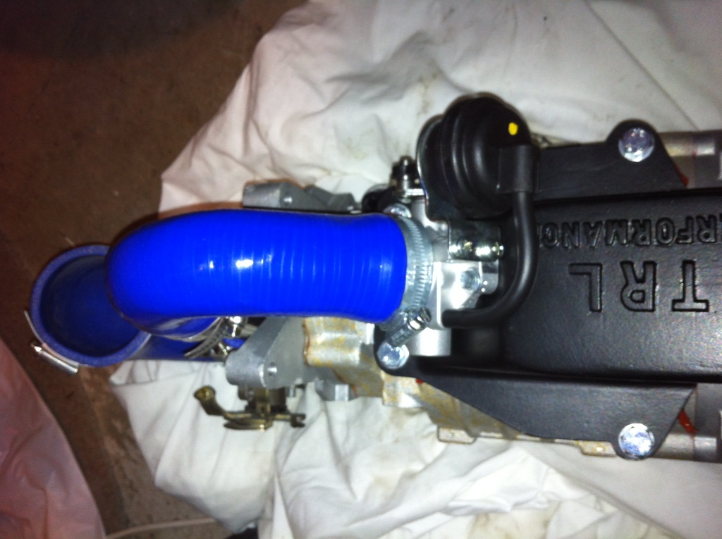

I have taken some photo's of the SC with all the ancillary bits connected. Have also taken some additional photo's of the bypass valve.
The valve appears to see vacuum after the second TB. I'm going to try putting the SC back on without the inlet and outlet connected, i guess this will rule out an issue with the actual SC.
If more photo's are needed then please let me know.

where are you attaching the vacuum line on the inlet manifold ?mobymidge wrote:I wonder if I'm loosing vacuum and therefore not opening the bypass valve.
The second TB is actually mounted on its side, the cable operates from the top.
if you start the car and remove it does the idle change - or car stall?
do you have a vacuum / boost gauge you can connect to this point on the inlet manifold.
if you are getting vacuum, is it the bypass valve that is not working - leaking or bent / binding
Edit - added comments below
Just so we are on the same page.
I call the TB on the super charger TB1 and the one on the motor inlet manifold TB2. When the car is idling there is vacuum in the inlet manifold as the motor is sucking against the closed TB2 butterfly. There will be some – but not lots on the other side of the TB2 butterfly –including the SC and its manifold and even less on the other side(air intake / filter side) of TB1 as it also has a closed butterfly.
So the vacuum line that connects to the SC bypass value must connect on the motor (motor inlet manifold) side of what I call TB2 as that is where the vacuum is (unless TB2 is open and even then if you are in cruse (part throttle) it will see some vacuum and open the bypass.
