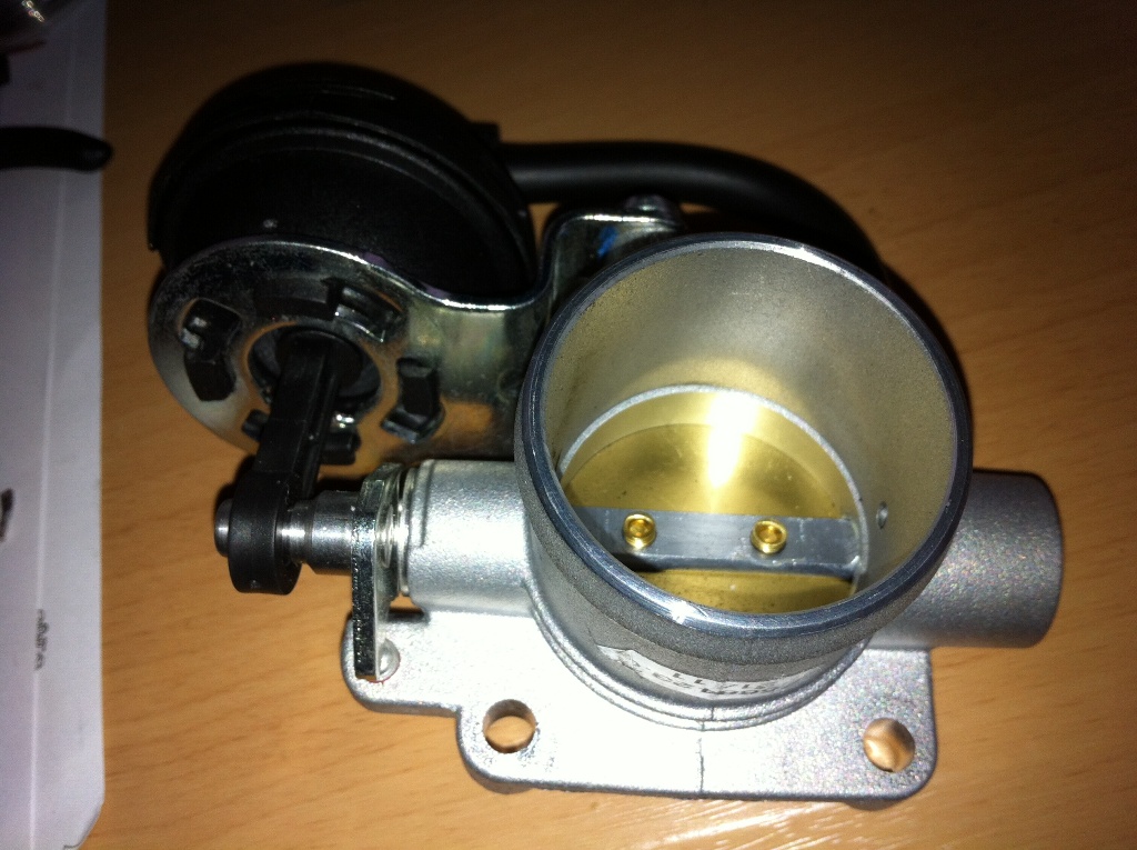

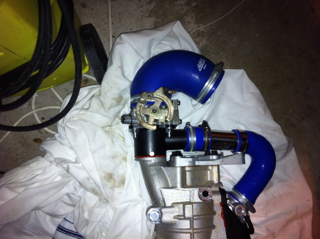

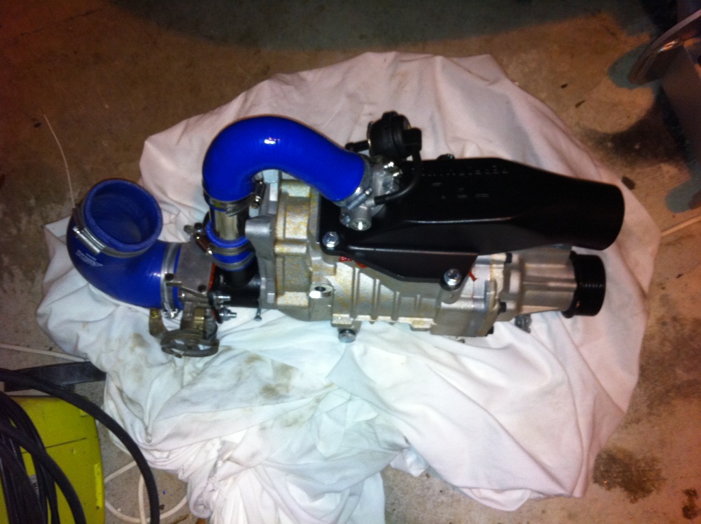

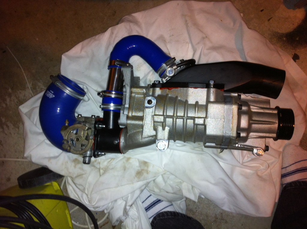

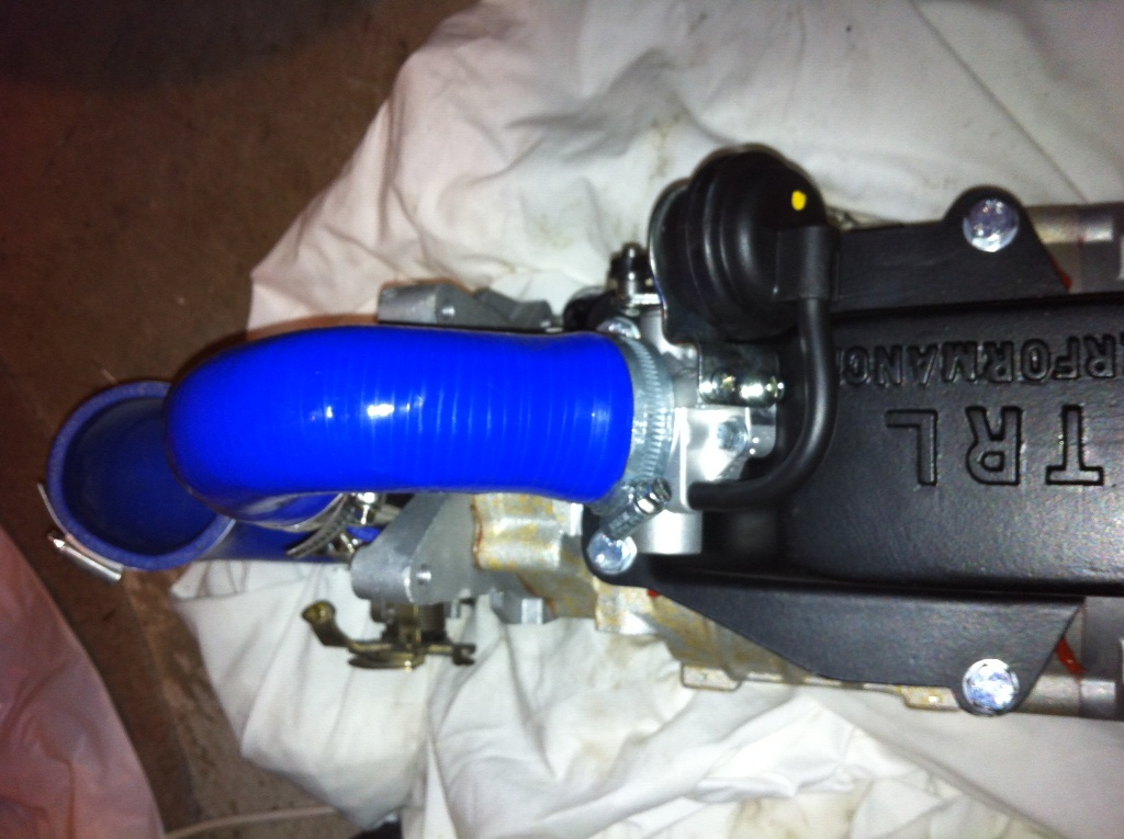

I have taken some photo's of the SC with all the ancillary bits connected. Have also taken some additional photo's of the bypass valve.
The valve appears to see vacuum after the second TB. I'm going to try putting the SC back on without the inlet and outlet connected, i guess this will rule out an issue with the actual SC.
If more photo's are needed then please let me know.
Bypass valve removed. Small opening on the inner RHS where the vacuum appears to be picked up.

Also meant to say, the bypass valve is very slightly open when at idle.

mobymidge wrote:Also meant to say, the bypass valve is very slightly open when at idle.
well that could be the issue. it sounds like you have the vacuum for the bypass not working - it should be in full bypass at idle.

Post by zippy2 » Wed Jan 11, 2012 7:37 pm
first time I have seen one of these and it is interesting that the TB on the SC is upside down (not that it should be an issue)

Post by mobymidge » Wed Jan 11, 2012 7:44 pm
I wonder if I'm loosing vacuum and therefore not opening the bypass valve.
The second TB is actually mounted on its side, the cable operates from the top.

Post by zippy2 » Wed Jan 11, 2012 8:24 pm
mobymidge wrote:I wonder if I'm loosing vacuum and therefore not opening the bypass valve.
where are you attaching the vacuum line on the inlet manifold ?
if you start the car and remove it does the idle change - or car stall?
do you have a vacuum / boost gauge you can connect to this point on the inlet manifold.
if you are getting vacuum, is it the bypass valve that is not working - leaking or bent / binding
Edit - added comments below
Just so we are on the same page.
I call the TB on the super charger TB1 and the one on the motor inlet manifold TB2. When the car is idling there is vacuum in the inlet manifold as the motor is sucking against the closed TB2 butterfly. There will be some – but not lots on the other side of the TB2 butterfly –including the SC and its manifold and even less on the other side(air intake / filter side) of TB1 as it also has a closed butterfly.
So the vacuum line that connects to the SC bypass value must connect on the motor (motor inlet manifold) side of what I call TB2 as that is where the vacuum is (unless TB2 is open and even then if you are in cruse (part throttle) it will see some vacuum and open the bypass.

Post by mobymidge » Fri Jan 13, 2012 8:57 pm
Connected the vacuum line up to the bypass valve and tried it at idle. Exactly as zippy2 said, the valve fully opened so it is clear that I had the bypass valve connected up incorrectly.
