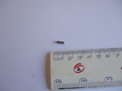

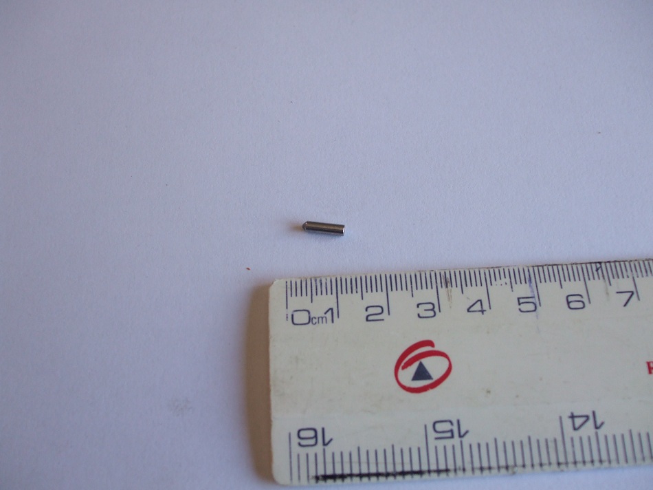

Got my clutch out so hopefully will be putting it all back 2moro with a bigger flywheel & BNT sprung button disc kit but i seem to have this little pin now & i have no idea where it came from!
Anybody seen one before?
Cheers!

Post by Euen » Thu Mar 17, 2011 3:01 pm
Did it come out with the old clutch or was it in the box with the new one?
Post by Keith Jones » Thu Mar 17, 2011 3:10 pm
Looks like one of the rollers from the spigot bearing.
Post by WideOpenThrottle » Thu Mar 17, 2011 3:33 pm
Thanks Keith
Funny how it goes it actually came out of the handle end of my torque wrench! [embarissing].
WOT

i was just about to say it looks like part of a torque wrench :lol: :lol:
