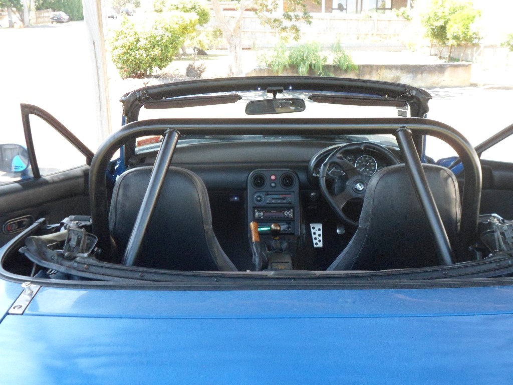

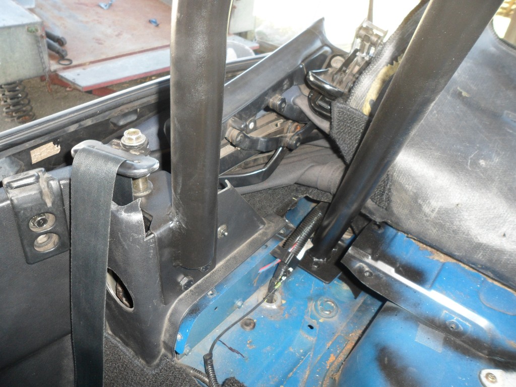

Well after having the roll bar in for about a month with rough paint, no plastic trim or carpet in the car, ive hopefully re-fitted it for the last time.
While the trim looks far from a factory finish, I don't think it looks to bad - a shame i had to cut holes behind the seatbelt to get my fingers through to hold the nuts. -Note: Buy more than the exact amount of nuts and washers, coz when you drop one in the seatbelt tower you have to pull EVERYTHING off again to get it!!
44mm Main hoop, 38mm rear stays.

Not bad :)
Looks tidy. Needs more low ;)

Where abouts did you get this bar from? :lol:
Post by tomtikki » Wed Jan 30, 2013 1:23 pm
How slack of me not to give them a plug as I'm really happy with it!
I took some pictures in to show what I wanted, they made some good suggestions (44mm for the main hoop, just add a diagonal if I want it race spec) and you see the result.
TTT Engineering, on Dominion rd. 09 6310687.
Can't remember the guys name .. But it doesn't matter as it's a small team and only a couple of them do the fab work.
Just between you, me and the web it cost me $600.

Nice, looks like it'd fit under a hard top too?

I hope so, it was done to a height that should clear underneath - I havn't had a chance to check though.

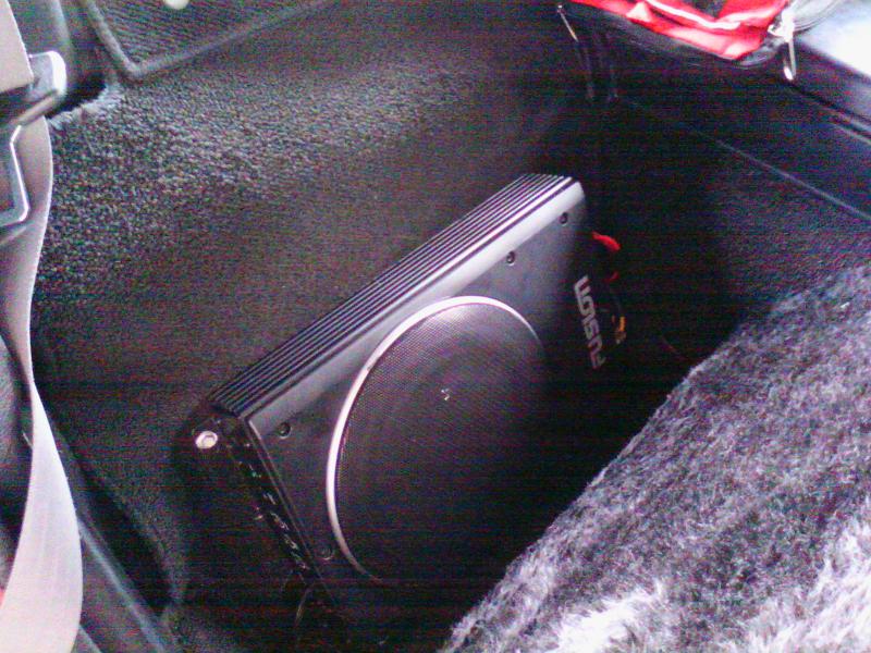

Thanks to the helpful information from members here, i ripped in to it and installed my new fusion 8" active sub.
I ended up putting it sideways, low behind the seat.
It sounds great and it not visually noticeable when the seats are in their usual position.

Nice one. I just got given one of those subs from a friend for working on his car.
Cant think where im going to have to put it as i need the seat all the way back.
Post by MrGrey » Thu Jan 31, 2013 5:33 pm
my seat can still travel right back, there is no restriction on the seat travel in my car.
maybe give it a try, otherwise you could always put it in the boot or your car?
definitely worth installing IMHO
Post by siren676 » Thu Jan 31, 2013 6:10 pm
Isnt the boot a separate compartment? Would have thought no sound would make it through :?
Post by MrGrey » Thu Jan 31, 2013 6:16 pm
from what I have read, boot subs would need a vent of some description into the main cabin to be effective *but* there is anecdotal examples on other forums of some people having success with the sub in the boot on an MX5.
if the drivers seat is out, then the other 3 options I figure are: behind the passenger seat, velcro'ed to sit on the parcel tray (for car thieves to see) or maybe in the footwell on the passenger side.

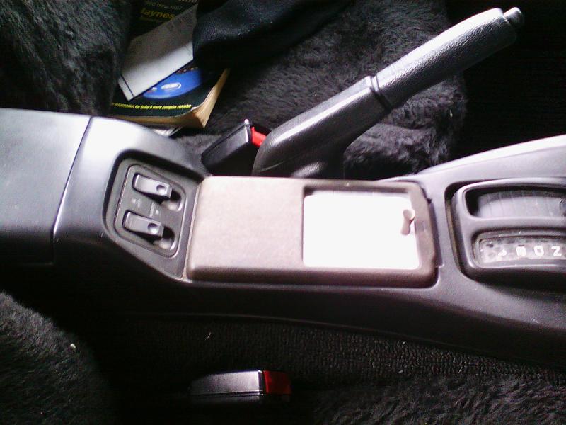

-=edit=- and I also got around to replacing the missing slidey plate on my ashtray with some alluminium...
sorry about the terrible photo :oops:

I have a sub in the boot...it gets through no worries
Post by chris » Fri Feb 01, 2013 8:44 am
Doesn't matter where the Bass is coming from it WILL be heard.
