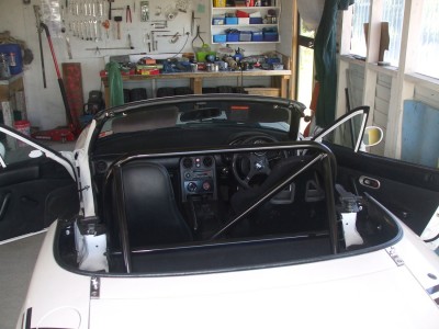

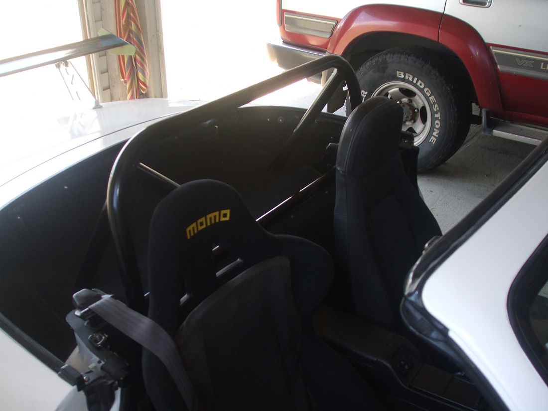

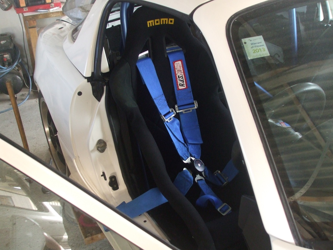

I am using a momo seat on factory rails with the seat-belt over the sides.
My hard-top fits over the roll bar so from the pics you may be able to get an idea of a bucket seats headroom on facory rails.
When i certed my car it was added on the list even though i believe if the seat is on factory rails a cert is not required.At 5'61/2" i have tons of headroom! :D
