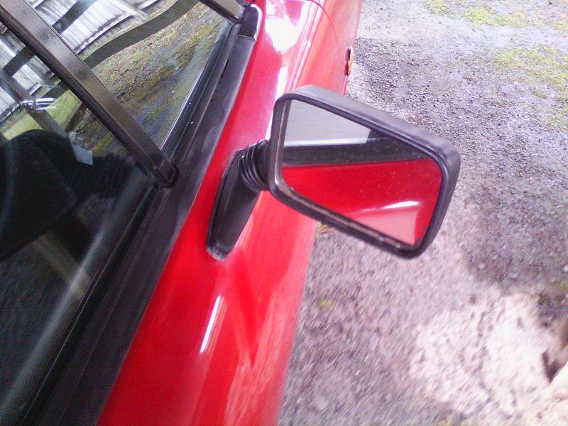

Post by MrGrey » Mon Feb 04, 2013 4:10 pm
yet more questions from me :P
my car came with (what I assume) are aftermarket mirrors and I was contemplating replacing them at some point with original style mirrors.
how hard are they to replace?
any tips, tricks or pointers you could mention for mirror replacement?
thanks in advance for your feedback :wink:
Post by chris » Mon Feb 04, 2013 4:13 pm
HAHAHAHAHAHA YOU ARE SCREWED THEY ARE GLUED ON.
Sorry - they should be fairly easy :) The Stock ones are 2 screws, see if you can get the cover off.

Post by chris » Mon Feb 04, 2013 4:24 pm
I'm glad I did ;)
Okay serious response. It looks like the black cover (possibly a cover) can be flipped off with a screwdriver.

Post by ross » Sun Feb 10, 2013 12:53 pm
Easy to replace.Flip back the cover and unscrew.
Make sure you use a no3 Phillips screwdriver as heads are machine screw heads are bigger than standard.
No need to remove the inner panel as nuts are welded inside the door shell.
If you need standard mirrors I have them.
