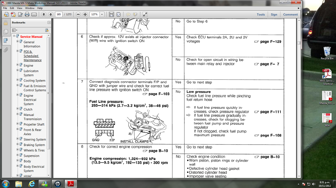

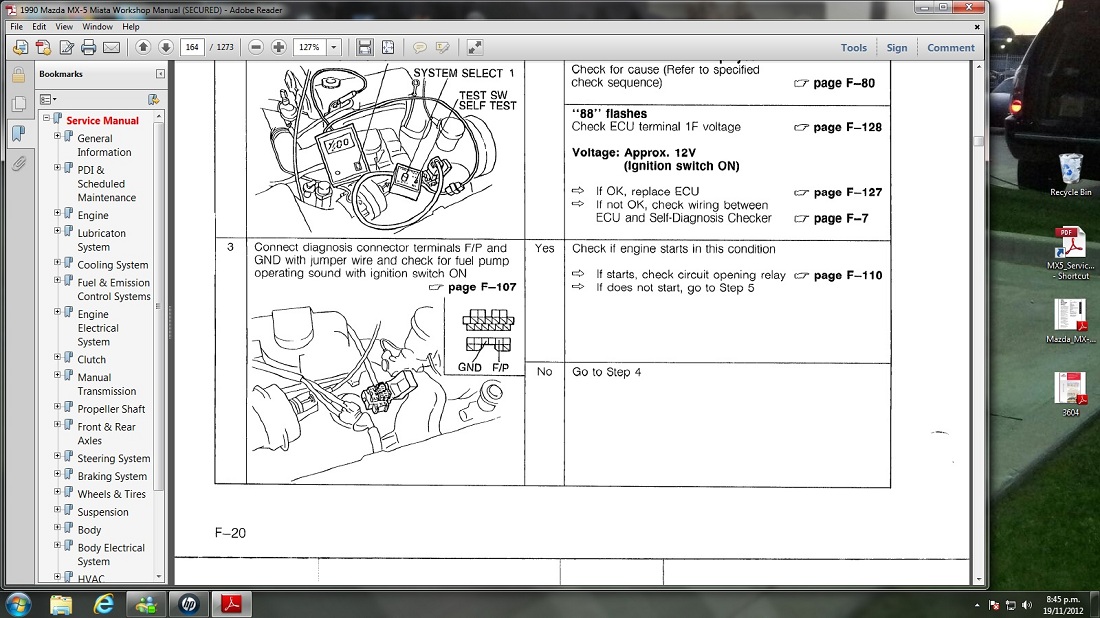

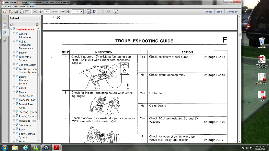

Post by WideOpenThrottle » Mon Nov 19, 2012 8:58 pm
Just in case it helps :D
