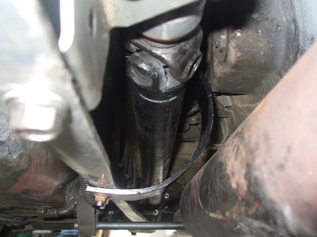

Made & fitted my driveshaft safety-loop :D
Plus wading through the Megasquirt info for downloads & tuning [doing my head-in big time :? ..please send panadol! ..or beer? Na! just send both! :D

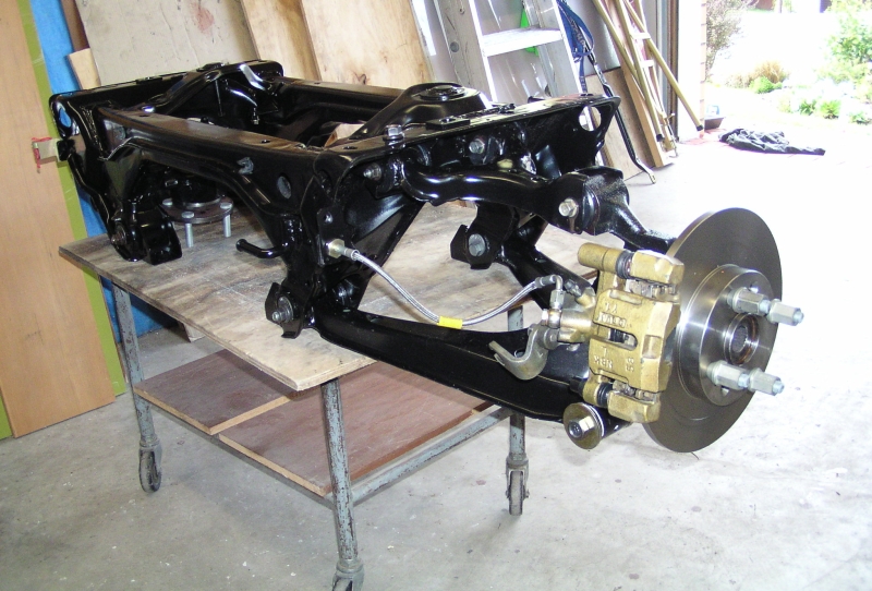

Slowly getting my NB rear subframe back together.
New wheel bearings, CVs, Energy bushes, stainless lines, new discs. Will be getting a 4.3 torsen in it.
To go in my 91 when I eventually get it back.

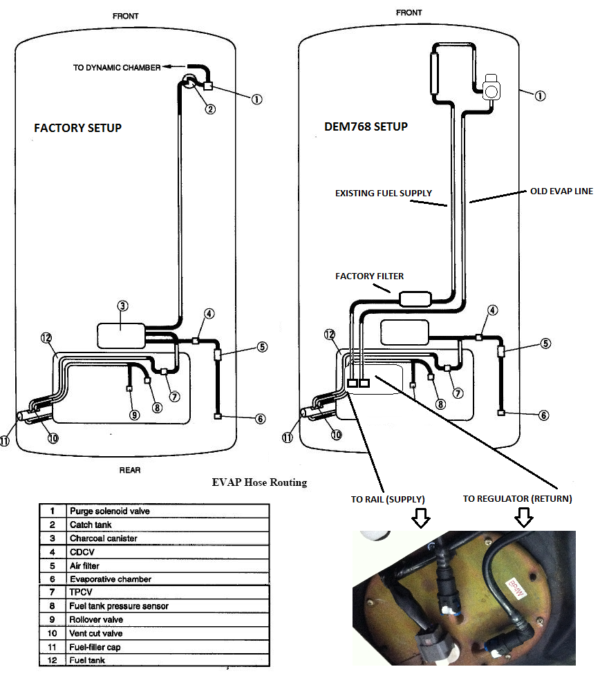

The charcoal cannister vents into the intake via a solenoid valve controlled by the ecu. However there is also a vent off the top that ends up in the inside of the front cross menber.
Post by Kieran » Tue Sep 11, 2012 2:34 pm
Theres a guy on Miata turbo that used his evap hardlines to turn the returnless NB fuel system into a return style system
That would mean the hardline has to go to the tank maybe its just the NBs that do

I may be wrong but I think that the the non US (or at least JDM) NBs have a run a fuel return. Certainly the fuel rails on the 2 99 heads that I have, have a return line from the FPR on the fuel rail. Kieran, I would suspect that your 98 would be the same spec.
