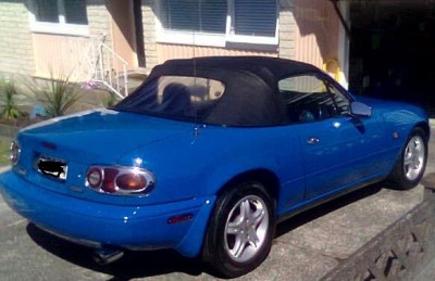

Blubee is a 1990 MX5 (really????) and shes screaming her nut off at me! Literally!
I was told by a friend that either the belts need tightening OR the air con needs to come out as there is a ?broken? bearing and get a shorter belt.
Been a savy kindof person, I've googled that awful noise and have read how to do it and seen the pix - but as wonderful as that sounds, I'm not really in the mood to munt my baby - thus I rather have it fixed by someone who knows what the are doing - without the big ripoff!
So - if anyone knows someone who knows what the heck they are doing please let me know ... referrals are good things! And if anyone knows what the estimated cost of repair is - please let me know!
Had Bluee for around 4 years and this is the 1st repair thing that I've had to do ...
Thanks!
