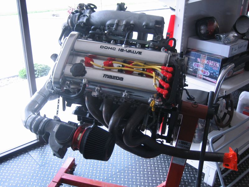

Post by mazline » Fri Oct 21, 2011 4:18 pm
I,ve got a mint b6 long nose crank engine from a car done 103,000km,with TODA chrome molly flywheel and ARC coldair box and headers in from Japan if keen,
Has also got HPC coated rocker cover i have just had done and 8mm leads ,will come with the motor if keen.
Our man in japan drove the car and said it got off it arse quite well.
PM me if keen.
