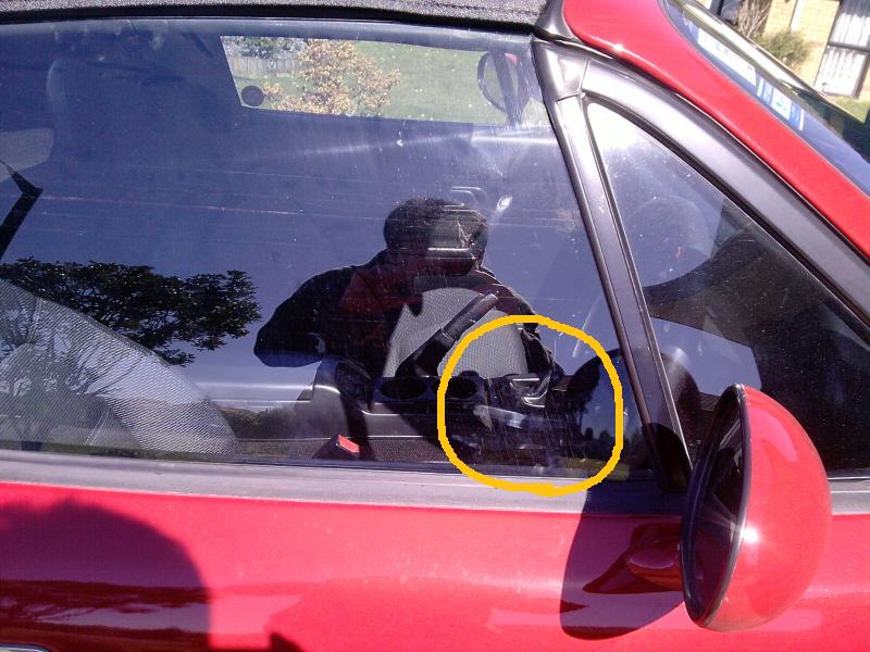

the problem i'm having at the moment is when i open and/or close driver side window, it makes a squeaky sound as well as leaving some minor scratches. and it's external side window, not interior side... making it even worse for me to part out to have a look... :(
can you guide me where to start from?

Where abouts are the scratches? by the window rubbers or on that bottom 'furry' strip??

viscarious wrote:Where abouts are the scratches? by the window rubbers or on that bottom 'furry' strip??
a photo attached and i have circled the area in yellow
i thought there were more scratches along the bottom strip but seems like only where i have circled.. i could be mistaken or seeing things.. :?

Asked around and 2 options seem to be a) some dirt has gotten betweem the window and felt, or b) that felt material could be worn through and the backing plate is scratching the window.
Is this a recent thing or gradual?

This happened on my wifes NA. The problem was the rubber weather strip on the out side had hardened and eaventually tore off. New rubber weather strips cured the problem completely. Cheers

ham wrote:This happened on my wifes NA. The problem was the rubber weather strip on the out side had hardened and eaventually tore off. New rubber weather strips cured the problem completely. Cheers
what is a weather strip? is it that bottom black strip thingy?
have you got part number for it? :D

I would say the weather strip is that bottom black strip thingy.
Yeah. The strip between top of door panel and the glass.
Part # MNAO158810F right hand side
Part # MNAO159810F left hand side
