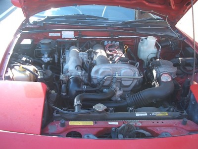

Post by WideOpenThrottle » Tue Apr 07, 2009 4:13 pm
Well here is a pic of the engine - looks like a 1600 to me but i could be wrong!

Post by WideOpenThrottle » Tue Apr 07, 2009 4:52 pm
As you can see- aluminium air box
coil pack to the passenger side
no shadows on cam cover letters-i can see no shadows on my pic indicating recessed lettering
Anyone dis-agree???

Post by Anthug » Tue Apr 07, 2009 5:13 pm
It's a 1600
Post by sprsta » Tue Apr 07, 2009 7:30 pm
100% 1600

Post by broomfish » Thu Apr 09, 2009 7:50 pm
another really easy way to tell is the air intake pipe. on the 1600 it goes under the radiator hose and on the 1800 it goes above.

Post by Habanero666 » Thu Apr 09, 2009 8:47 pm
Its a 1.6 ,look at the CAS position.
Post by sprsta » Thu Apr 09, 2009 9:57 pm
yes 1600 like this
