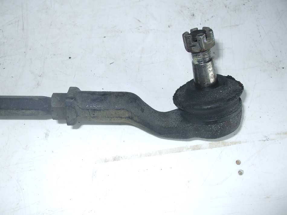

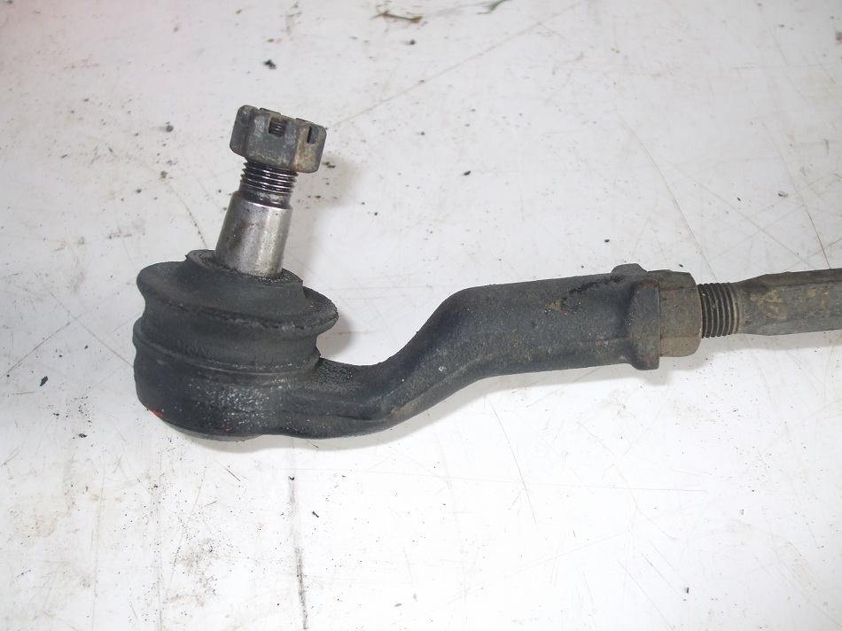

And this is it, my tie rod ends look like this (except factory)
*Edit: i cant post pictures as my post count is low so imagine a non straight tie rod here

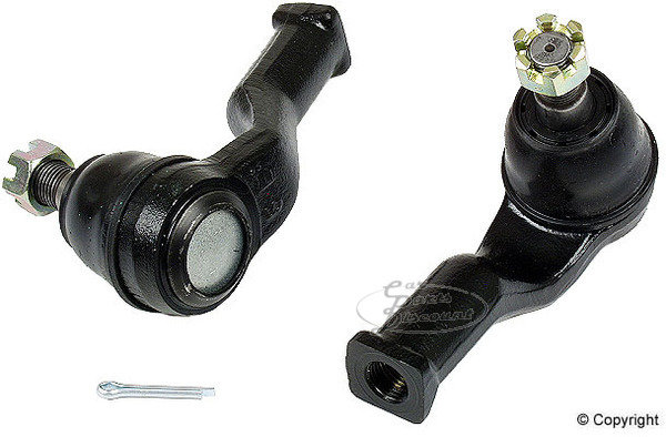

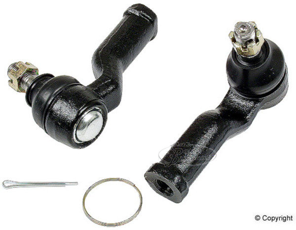

and everywhere i go to get a new one insists that i should have these
*Edit: imagine a straight one here

Post by WideOpenThrottle » Fri Apr 08, 2011 4:09 pm
HI -
Her is the left & right sides to my 89 power steering rack

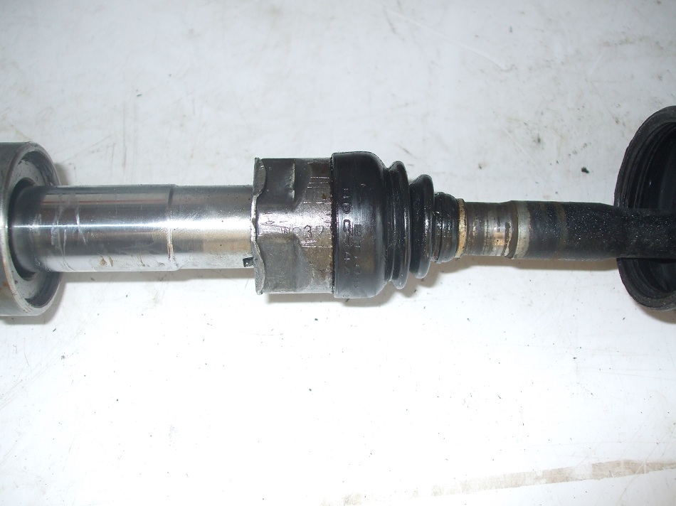

Post by WideOpenThrottle » Fri Apr 08, 2011 4:17 pm
And this is the knuckle :D

Post by Born_disturbed » Fri Apr 08, 2011 6:42 pm
Okay all sorted now :D
sprsta - when i went in to each place i had it with me, they had no luck matching it.. Familia ones are vastly different and i even had my mate at partmaster check every single end they stocked, none were even close.
WOT - That looks like my one there ;)

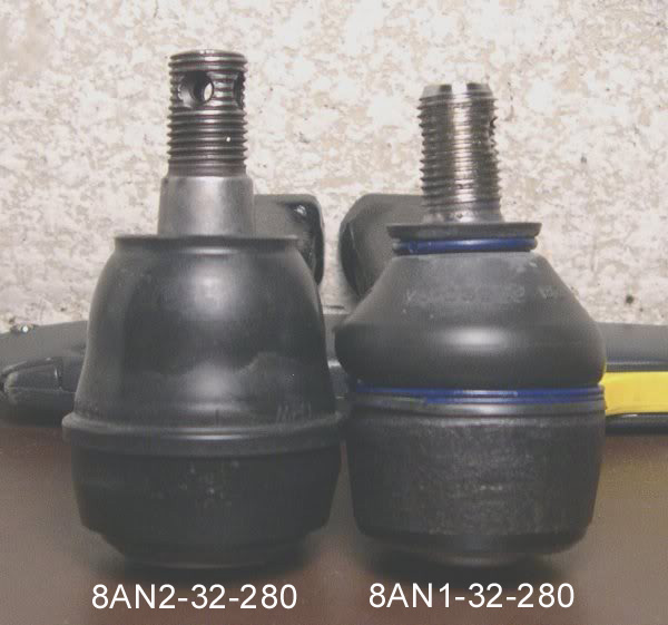

Post by broomfish » Sat Apr 09, 2011 7:56 pm
was looking for the tie rod ends for an NA with bilstein suspension the other day and found this pic online
8AN2 is for bilstein model, 8AN1 is non bilstein.

Post by broomfish » Mon Apr 11, 2011 10:31 pm
looking on allmazda.net there are multiple aftermarket part numbers for the first one, but no aftermarket for the 2nd one so i think Genuine only
listed at 87 euros so about the same as the US price

Post by Kieran » Thu Apr 14, 2011 12:41 pm
Or you could always swap to some of these reinforced tie rods
apparently they increase steering angle to the point of insanity
