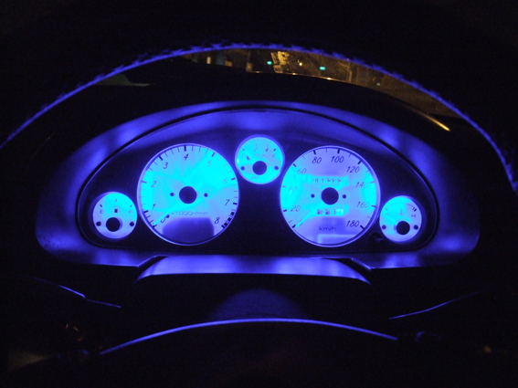

Several months ago I undertook the task of finding a way to make my dials light up blue.
My first step was to replace the standard black dial faces with white ones so the light would shine through the whole dial and not just the numbers. The replacements I got can be found here.
Next it was recomended to me to use blue silicone bulb sleeves (at a cost of about $4) made by Narva to cover the standard yellow/white bulbs. THIS DOES NOT WORK! Do not use these sleeves, all they accomplished was to change the yellow/white light to an unattractive yellow/green light.
I then tried to remedy this by changing out the standard light for a Narva ultra-white light (at a cost of $15). All this served to do was make the light slightly more green than yellow....
Weeks later I stumbled upon a NZ site that sells all manner of LEDs and bulbs. Here I found these lights (at a cost of $8 each). They arrived two days later by courier and I installed them only moments ago. I am very happy with this product as it creates a real blue light not a washed out white or green. I would recomend to anyone attempting a similar undertaking to go straight to ledbulbs.co.nz instead of wasting time and money on other, cheaper fixes.
All up I spent nearly 3 months and over $100 trying to find a solution.
Cost of final solution: 3 days, $37. (plus cost of dial covers)
You may notice that the blue does not diffuse very evenly. This is because of the perspex mounts that the dials screw into. The standard mounts are designed to direct the light at the area with the numbers because the standard dials only light up at the numbers. I am currently working on some custom mounts that will diffuse the light correctly.

How many led bulbs did you end up using?
Anthony.
Hojo
Posts: 26
Joined: Mon Apr 06, 2009 8:23 pm
Location: Lower Hutt
Post by Hojo » Wed Jul 01, 2009 1:57 pm
4, one for each existing light. When you take the dash apart, assuming you have a Mk1, there will be about 8 light holders. Four of these holders are black and the other four are a dark green. The dark green ones hold the bulbs that light up the dials. (Ignore the other ones as these are for things like indicators and hand brake).
Re: Dash Light Replacement - Solution!
Post by sprsta » Wed Jul 01, 2009 3:26 pm
forgot to add the $75 for the dial covers or did you not end up using them?
post us a pic of your efforts

Post by Hojo » Thu Jul 02, 2009 10:29 pm
I did indeed end up using the dial covers. I will try to post a pic in the next few days.
