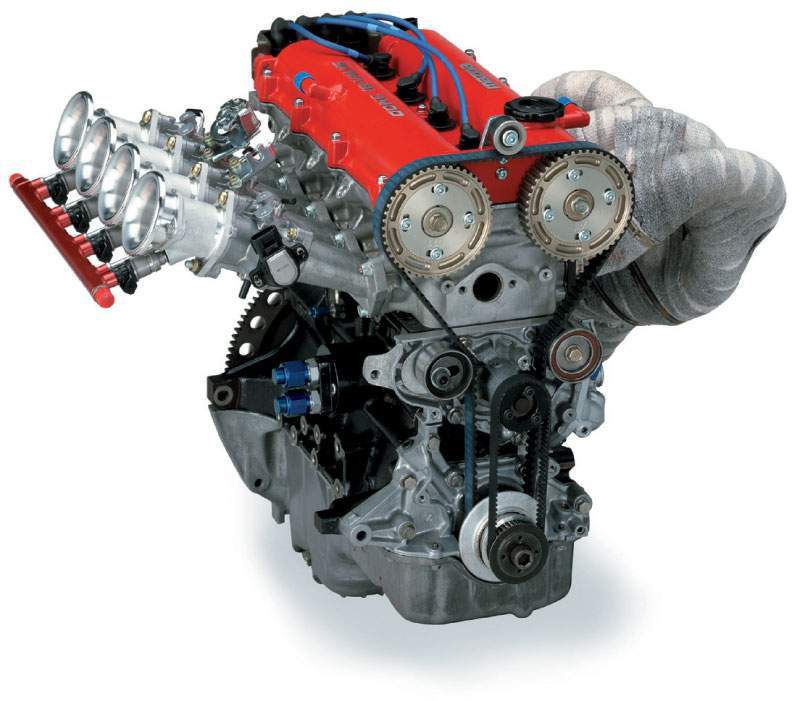

The 4AGE (AE111) ITBs take the brake booster off a single intake and the crank case breather off another (intakes 1 and 4). Vacuum for the FPR is fed off No.1 and there is another small vacuum line off No 4 which drives an actuator on the throttle which I assume to be some kind of idle speed control. There doesn't appear to be a feed for MAP.
If you need a MAP feed, most suggestions are to link the vacuum from all 4 intakes to get a more consistent vacuum reading.
One of the advantages of ITBs is that they allow you to tune the intake length for the rev range you want your peak power at. They also regarded as being more responsive than a single throttle body with a plenum chamber. The other thing in their favour is that they sound absolutely brilliant.
On the downside, they can be a pita to tune a they all have to be balanced and it doesn't take much to knock them out of tune. You would also need an after market ecu to run them on a MX5.
Poison, yes they do retain the injectors, but depending on the type of manifold you get they can also allow you to move the injector further away from the head, allowing better atomisation of the fuel before it enters the combustion chamber.

you don't need the plenum, but then if you're running them 'naked' you'll either need carbs or a ECU that can handle the funky non-linear throttle-airflow-MAP response.  Also the MAP signal can be pretty jagged, I understand. And putting a filter over the throat messes with the airflow. And then theres balancing flow between them. Nothing's easy ;)
If you have the plenum, there's some issues with sizing/ tuning it ... Chris Chu in Canada did a lot of messing around with this.
There's a BRG running around on the North Shore with what sounds like IRTBs ... it's the one with the dirty fart blast mark around the tail pipe ;)  Sounds cool, though any turbo would leave it sucking dust thru those pretty IRTBs :D
