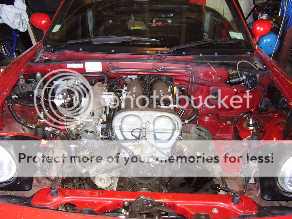

So here is what ive done at this stage, basically just dismantled everything getting ready for the conversion
Sorry about the crap camera phone photos, i will use a proper camera from now on when i can,
Since removing all of the air con and cooling system i have heaps of room in the front of the engine for my intercooler and new radiator,

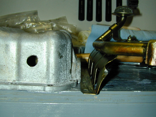

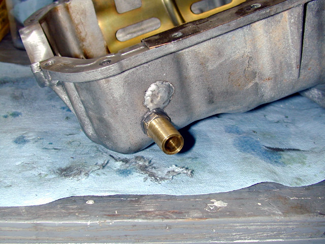

also, i am going to take my sump off to weld on a fitting for my oil drain and was wondering where exactly to do this, so i did some research and only found this,
http://www.rev2red.com/images/cars/faq/oilports.jpg
now should i put the fitting where the big red cross is or should i copy where he has put it? or is there somewhere else i should put it?

get your turbo manifold made up and your turbo mounted before you do the sump.
The drain line needs to be nice and smooth with no kinks etc.
Once you have the turbo on you can get a feel for where it needs to be.
You dont have to weld it on either. Most people just drill and tap the sump and then use "JB weld" or loctite 3805 to seal it and lock it in place.
I used a goodyear 5/8" Drain hose and a (3/8" ??) BSP fitting into the sump. Its been in there for 3 years now and i havent had to touch it since the day i put it on.
the below pics i saved from the net showing where it normally goes. As you can see in the second pic, you have to be careful of the oil pick up line and scavenge plate. The further back you go the more careful you have to be.
