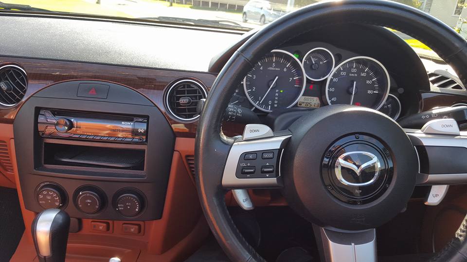

I just got myself a 2005 roadster NC (that's a 2005 NZ MX5 and yes, Japanese models include a 3rd gen 2005 NC) It supposed to have Bose head-unit, but it was fitted with a Sony Xplode as you can see in the photo attached
