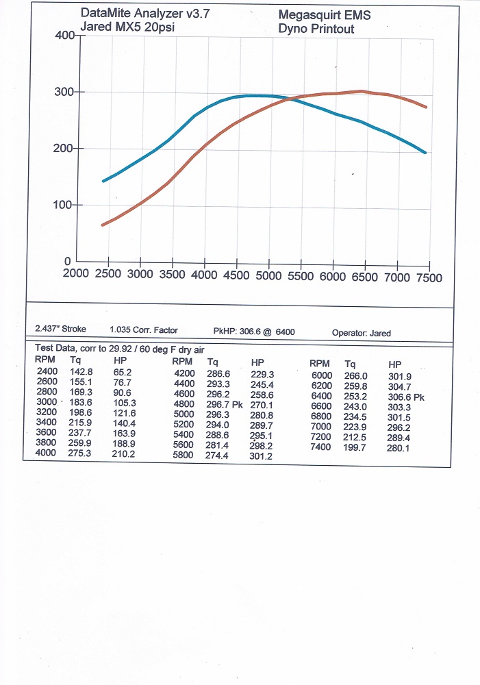

With four spare BP engines lying around - I figured I'd test the maximum reliable power from a stock BP block.
Been meaning to do this for a while - but as usual work commitments prevail.
But had a spare few hours this morning - so fitted a boost solenoid and wired it up to the ECU in the old Turbo MX5, and cranked the boost up to a steady 20 psi (from 14)
The results were impressive, with a steady 302-307hp at the wheels, run after run
The best was 313, but with very mild detonation at the peak of the torque curve, so 306 was the limit on a safe tune.
With over 20 dyno pulls to 200k, and an afternoon of abusing it (and a whole tank of gas) The motor seems as good as ever.
Although the next trackday will be the true test
Does anyone know how far anyone has pushed the BP block (reliably)?
The Mercans quote some silly figures but they're about as honest as Winnie P
Have attached dynosheet as bragging rights. :D
20psi Td05 16G

Post by Teamjelly » Sun Aug 31, 2014 8:32 am
Yeah, Have dropped the Rev limiter to 7000, no point revving it past that as the power is already dropping off.
I'll wait till something goes wrong before taking the head off and having a look inside
Am building a fully forged motor at the moment, with much lower compression, so thought this would be a good test of the stock BP engine durability. :)

Post by Teamjelly » Tue Sep 02, 2014 5:24 pm
I think the rod bearings will the limiting factor in the BP engine
Compared to something like the 4G63 they're a lot narrower, which increases the load per square inch
I know the Mazda Rally team were having the same issue when running 25+ psi
Changing the bearings per session.
I'd say 450hp at the engine is about the factor for reliability on a forged motor unless serious money is spent on a high psi dry sump setup
But will have conclusive results by the end of the year.
With a Td05 20G running 25 psi on fully forged motor, we'll see what the BP motor is capable of.
