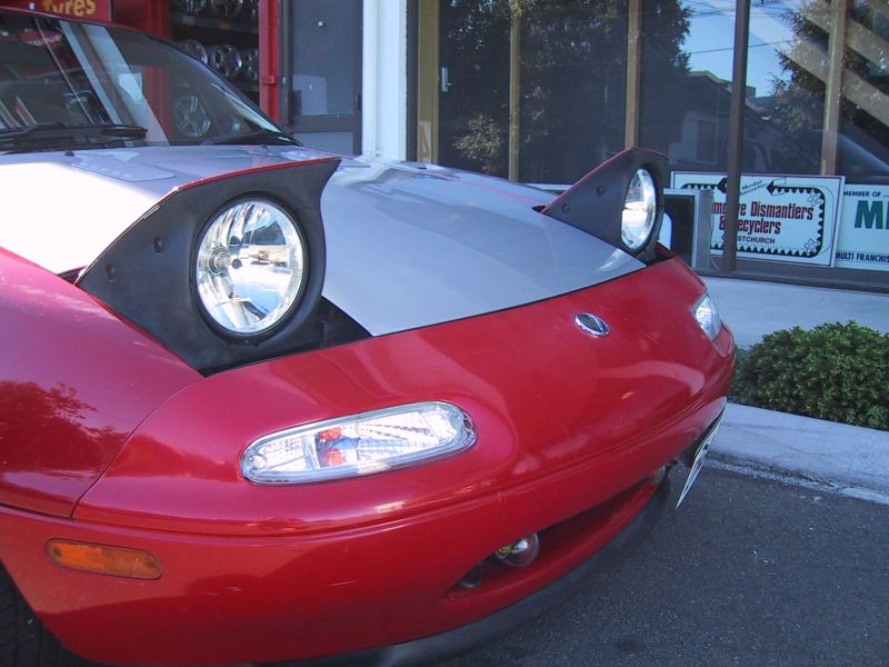

Post by brownie » Sun Oct 20, 2013 11:28 pm
these are fairly good,if not "Brilliant" at night,
Sold a few sets to other forum users as well as a set for my own car,"Raybrig"
Polycarbonate lens,Manufactured by Stanley which is one of the main "OEM" companys.
