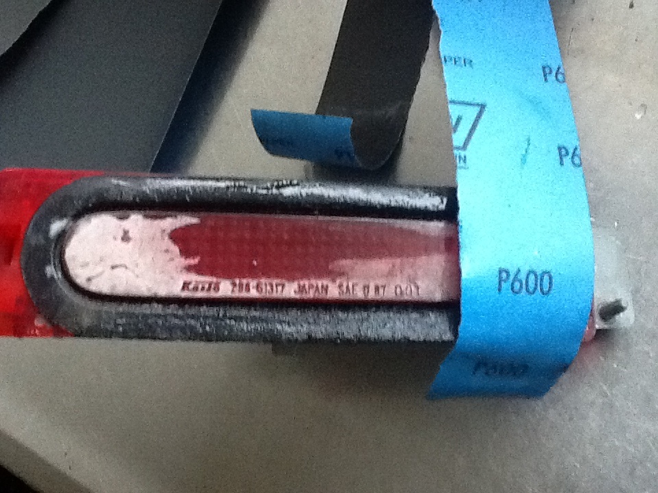

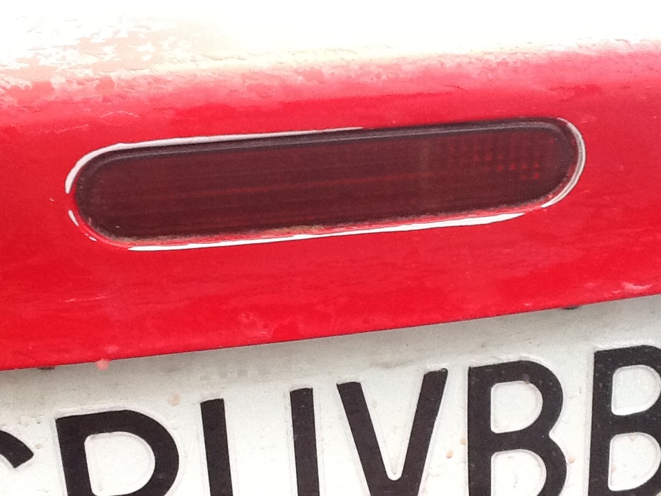

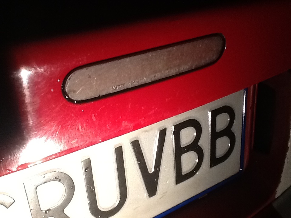

I had a rain off this afternoon so scored some wetndry on way home. 3 sheets $7. Ater about 30 seconds with 600 grit the lens was looking like this.

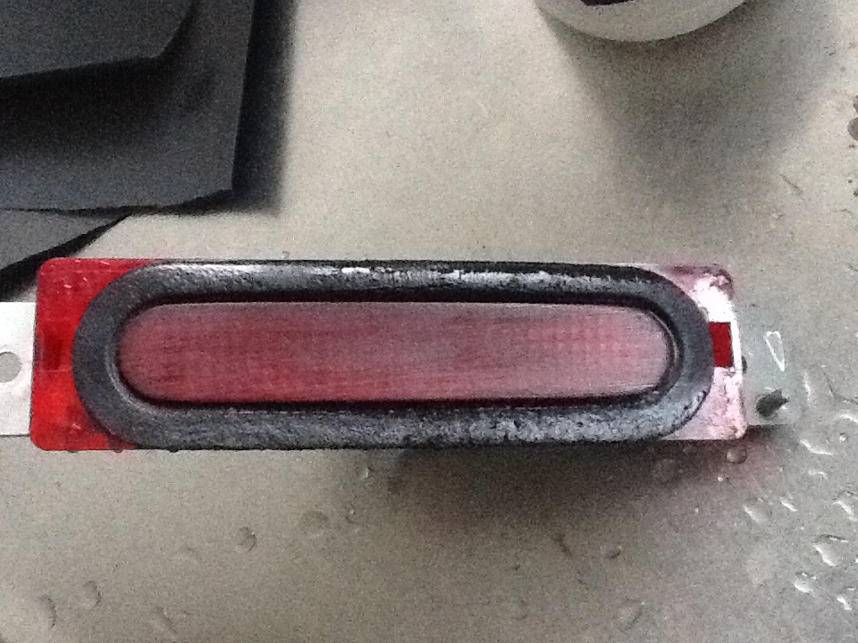

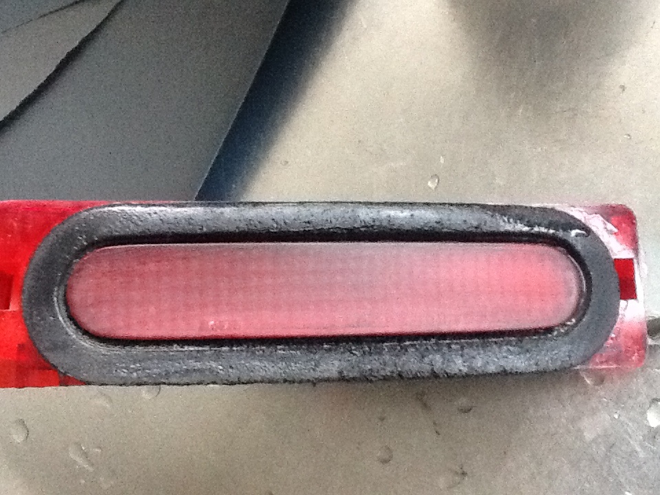

Then a stint with 800 and then 1200
Finally rreplaced lens and hit it with a polishing buffer. Took a bit of paint of around the lip but thats no drama.
Pics appear to have loaded in reverse order sorry. Also got a double insertion of first pic. My first time doing multiple pics.
Thanks for the polishing advice everyone. Hope this is of help and inspiration to others suffering hazy lenses. Im booked for a WOF tomorrow morning so hopefully allwill go well and ill be back on the roads. Just in time for the rain. Should be fun
