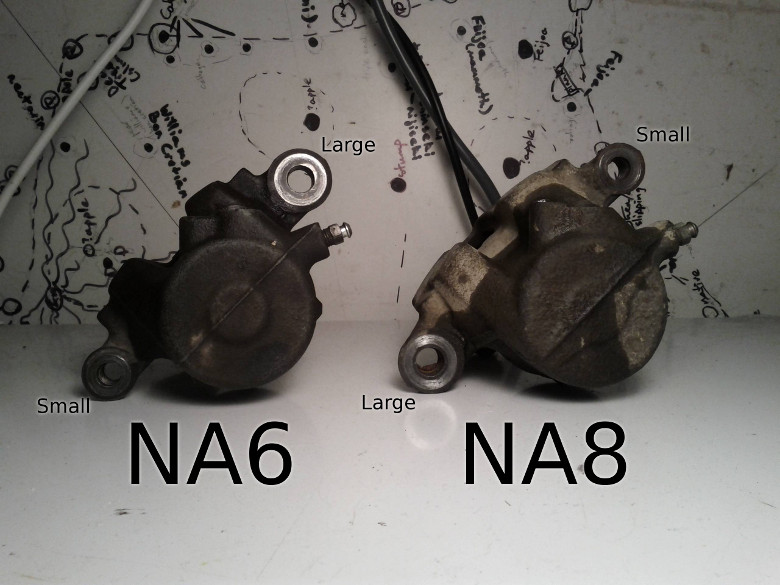

by marcellarius » Tue Sep 10, 2013 6:21 pm
The calipers are NOT identical. Having been burned by this today, I thought I'd set this straight.
The front calipers have a big slider and a small slider. On my 1.8, the small slider is at the top, the big at the bottom. This is reversed on the 1.6 caliper. Not identical.
I suspect if you have a pair, you could swap the left/right brackets and make them work.

by SLYDIT » Tue Sep 10, 2013 7:26 pm
its common knowledge that you have to swap sides when doing the conversion.

by Snapfrozen » Tue Sep 10, 2013 7:29 pm
SLYDIT wrote:its common knowledge that you have to swap sides when doing the conversion.
This. The piston diameter and all hydraulics are the same between them. You will have the same braking power no matter which caliper you use. You need to swap left to right but otherwise only the rotor and the pad retainer change

by marcellarius » Tue Sep 10, 2013 7:31 pm
I recall reading that now, but it doesn't make the calipers identical.
In my situation I couldn't find a replacement NA8 caliper in Hamilton so assuming that they were "identical" I bought an NA6 caliper (the much cheaper option..)
