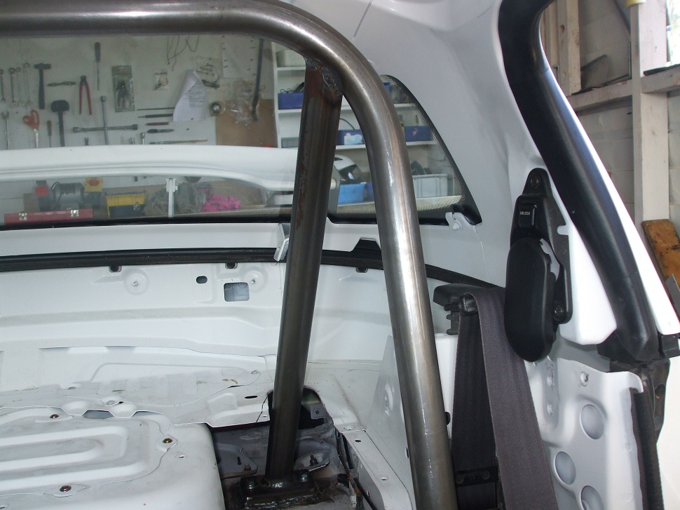

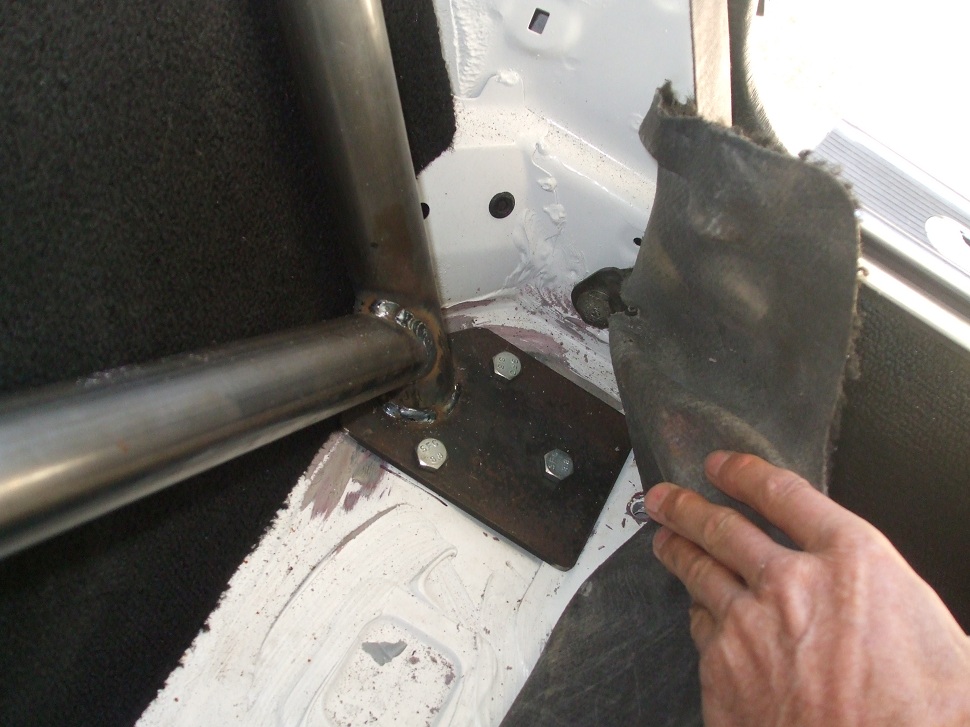

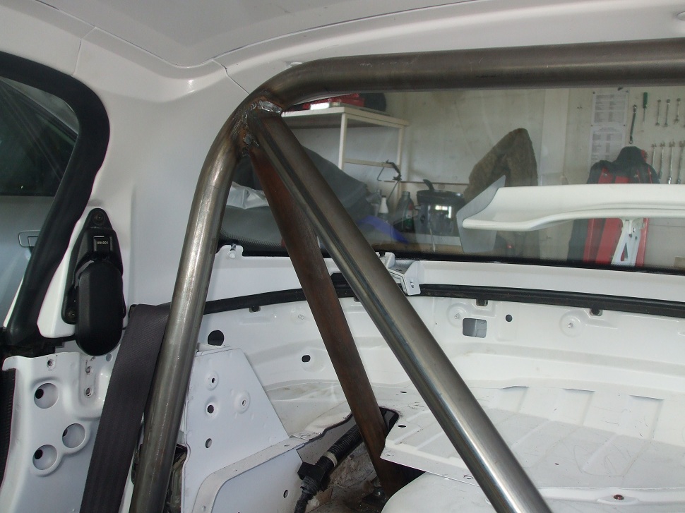

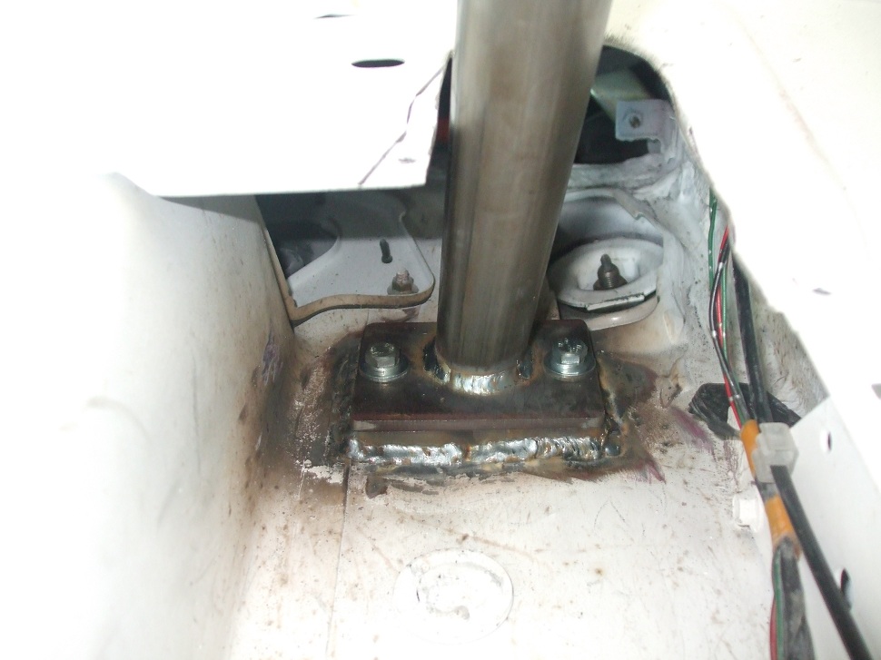

Post by WideOpenThrottle » Thu Oct 06, 2011 10:04 am
Roll-cage fabricated & fitted-in the end i had it done by Kevin Hunt of Redline Enterprises in Waimauku. Done a great job too!....plus its a bolt in one which is what i wanted.
Downside is seat travel for anyone tall as its in the way for any Formula one driver taller than about 5' 8"

from memory the msnz rules say that the main hoop plates have to be 120cm2 and have at least 3 8mm bolts and the back stays have to be 64cm2 with a minimum of 2 8mm bolts.
that bar posted from Wide open is a good solution.. only mod i would make is have the rear stay plates not welded in but sandwiched as per a normal bolt in...
i think i'll copy those pics for future reference... :P
oh P.S...where do you bolt your harness? will it have a harness bar?
Post by WideOpenThrottle » Fri Nov 11, 2011 8:32 pm
My harness bar was left out on purpose until i get a race seat & then decide how best to put one in.
I would have prefered sandwich rear plates too but for some reason the engineer said it was too difficult because of the main chassis rail?
