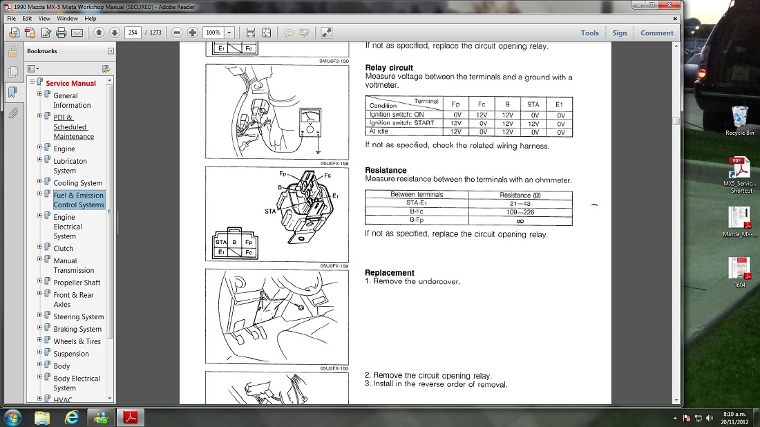

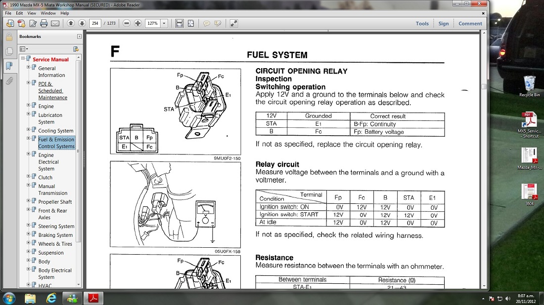

Post by WideOpenThrottle » Tue Nov 20, 2012 7:56 am
My fuel pump comes on just with ignition..but thats because of the megasquirt now i think.
Post by WideOpenThrottle » Tue Nov 20, 2012 8:22 am
More info..
