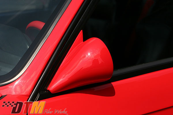

I took my OEM mirrors off, will be replacing them with blanking plates. I'll be putting aftermarket close in ones (S14?) in up by the A pillar ultimately, but for the moment I've got cheapies from Repco there, like this but no remote adjustment.
Mounting on the front window surround was a doddle.
going for something like this
Currently something like this

NicF wrote:I took my OEM mirrors off, will be replacing them with blanking plates. I'll be putting aftermarket close in ones (S14?) in up by the A pillar ultimately, but for the moment I've got cheapies from Repco there, like this but no remote adjustment.
I made some polycarbonate front quarterglasses so i could drill and mount my mirrors to them like this
the drivers mirror is all good to see out of but the passenger one had the window runner in the way of some of it
not that i really used them much
