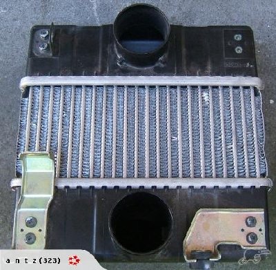

I was going to mount it infront of the radiator so heatsoak shouldn't be too much of an issue. I've got quite low underbonnet temps anyway due to vents in the bonnet. I'm thinking I'll go with the RX7 intercooler for starters (it's only $15) and I can upgrade if and when I need to.

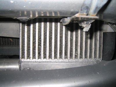

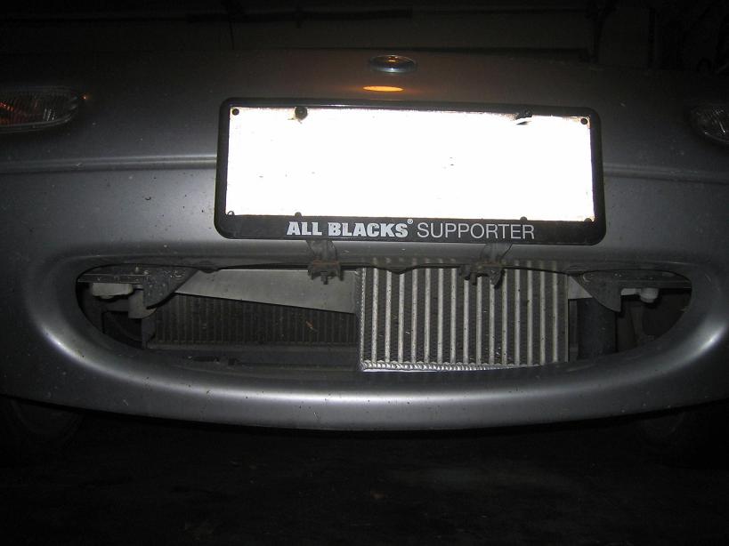

I popped down to the garage to take a couple of pics so you guys can see the size of the unit I have installed. Its not too large and allows plenty of flow to the rad.
Hope that this helps (sorry if this double post to email - I had to edit the original posting due to posting the same pic twice)

Cheers for that, doing a bit of research the RX7 intercooler (bought it now) should be okay for the 12PSI I hope to run.
