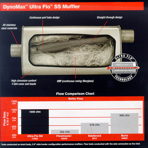

Post by jif » Wed Jun 07, 2006 10:53 am
here's a pic of one with the 'glass type packing
http://www.a-1performance.com/images/ul ... inpage.jpg

Exhaust Replacement Experience
Post by jif » Wed Jun 07, 2006 10:57 am
mufflers use either some kind of glass wool (like Pink Batts?) or
stainless steel wool (like pot scourers) as packing around the pipes
to absorb the sound. The glass type (cheaper) tends to burn up after
a while resulting in less muffling effect.
I hear the RX7's (have to ) use the s/s type due to their hotter
exhaust. The fireballs probably don't help either ;-)

I suspect the Borla is the glass fibre type then... its certainly got louder over the time I've owned it. If they re-pack them, what do they do? Cut off one end, repack, and re-weld the end back on? I guess something like this might allow a repair of anything internal that is loose. I know nothing about this...

that's my understanding of it. Can anyone in Wellington recommend a place?
