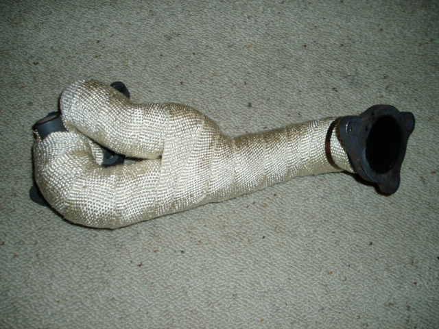

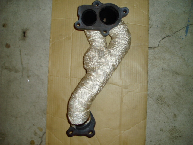

I was coming to the end of everything when i last posted and since then i have just tidied up a lot of my ecu install and everything associated with that, i then built the rear half of my exhaust system
This was my first ever attempt at an exhaust system and im pretty happy with how it turned out, just dont look to closely at the welding
Since then I have completed the last section of my intercooler piping and connected everything I needed to run up, I still have a few things to tidy up but here is a pic of how it is now
