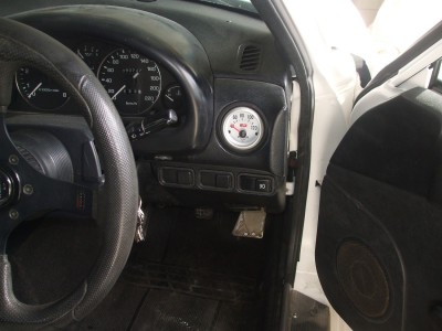

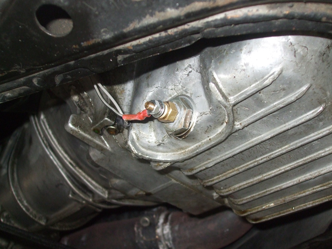

Post by WideOpenThrottle » Tue Jan 22, 2013 4:48 pm
To enable me to keep an eye on things at the track i have installed an oil temp gauge with the sender threaded into a spare sump nut.
Water temp gauge is next on the list.

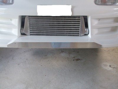

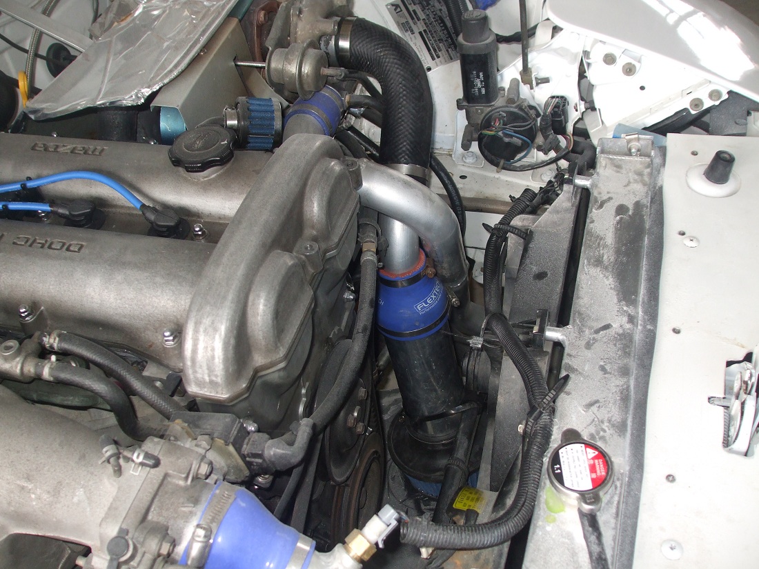

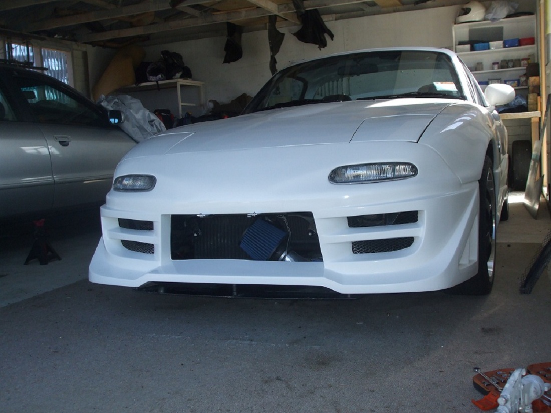

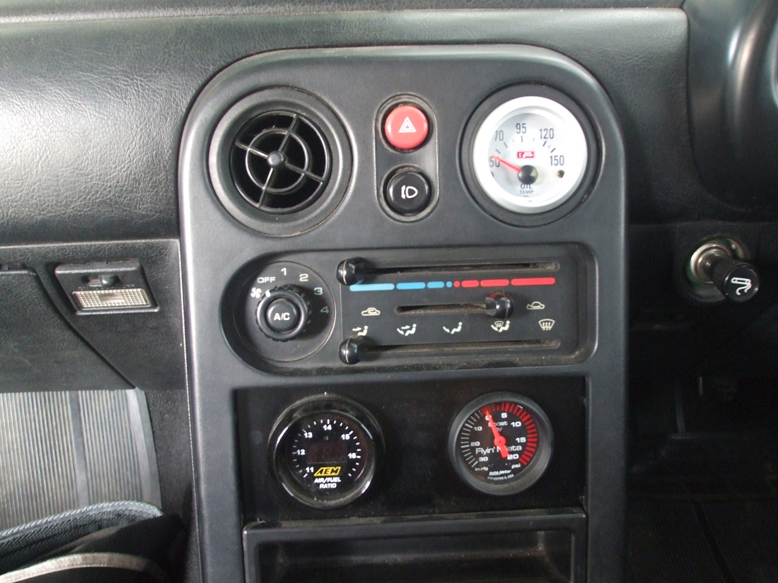

Post by WideOpenThrottle » Sun Feb 03, 2013 5:33 pm
Finish my mods today, almost...water temp gauge,lowered pod filter for cooler air,repainted front bumper with front lower plate.
Just need a bung for the temp sensor welded on the ali coolant tube.
Post by warrior » Sun Feb 03, 2013 9:14 pm
will the filter pick up water being that low? A bit hard to tell from the pictures.
Post by WideOpenThrottle » Mon Feb 04, 2013 7:39 am
Shouldnt do...its behind the the IC & Radiator plus i have a full lower splash plate now.
My first turbo experiment had it in front of the radiator & even in the pouring rain at Taupo never had any issues...in fact they run better & cleaner with moisture injection.
