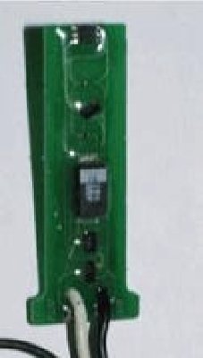

talked to my mate today regarding air temp sensor he said it couldnt make a pwm signal without a power wire and says it has to produce resistance of some sort (maby a pwm wave of resistance?)
he said i really need to find him one to reverse engineer
might try emailing jeremy or keith again and see if they know any values for it or how it works

If there are no obvious electronics at the sensor it's really unlikely to be a PWM of any sort, there are two common types of temperatures sensors in use commercially. They are resistive and will vary from 100ohms to 20Kohms at room temp. And thermocouples http://www.sensorland.com/HowPage017.html, thermocouples tend to be very small and high resistance.

You can't decide a sensor type by size, a thermocouple sensor bead can be tiny or large depending on it's package (covering), for example the thermocouple is the tiny bead at the tip of the blue heat shrink in this picture. We use lots of types at work and you can't always tell just by looking at it.
http://en.wikipedia.org/wiki/File:Thermocouple0002.jpg
But that said, I see Jif said in an earlier post that they are PWM and I would say you take his word as gospel (unless he says anything bad about me...lol) and given there are some onboard electronics it could well generate a PWM signal. Many things could fail, from a crack in the sensor bead to an electronic fault, or even a faulty input.
My best advise is to send the whole thing to Link in NZ and they will bench test it within a couple of days. I think it cost me about $75 a couple of years ago. Well worth it to put the whole issue to bed, they may moan if oyu have the FM software but they can still fully bench test it. Avoid the sales guy (Full of S....) and talk to the tech guys. They could even plug in one of their own chips to bench test the hardware.

Jeremy Ferber to me
show details 6:00 AM (1 hour ago) Reply
Hey Cole,
All I know about the IAT sensor we sold to go with our Link software is that it outputs a low voltage square wave. If you're running the Link software however, it won't work- they probably just use a GM standard IAT sensor. Not sure.

taken from two sources
from miata.net
This thread is located at:http://forum.miata.net/vb/showthread.ph ... to=newpost
from miata.net
from my mate who will make sensor for meOriginally Posted by sprsta
does anyone know how the miatalink air temp sensor works?
Yes.
Quote:
i have been told it makes a pwm signal
it does.
Quote:
Simply isn’t possible with two wires
Hmmm, that's not entirely true ... how about: one wire has a pull-up resistor, and charge is taken from it through a diode and stored on a capacitor. That can then be used to run a semiconductor that shorts that same wire to ground for short periods, the length of which can indicate temperature.
HTH,
Rod
If it shorts the same wire to ground, then the capacitor discharges and there is no voltage? Unless there is synchronisation between ECU and sensor, and the ECU uses a tri state pin. Once again, sounds too complicated to be realistic.
