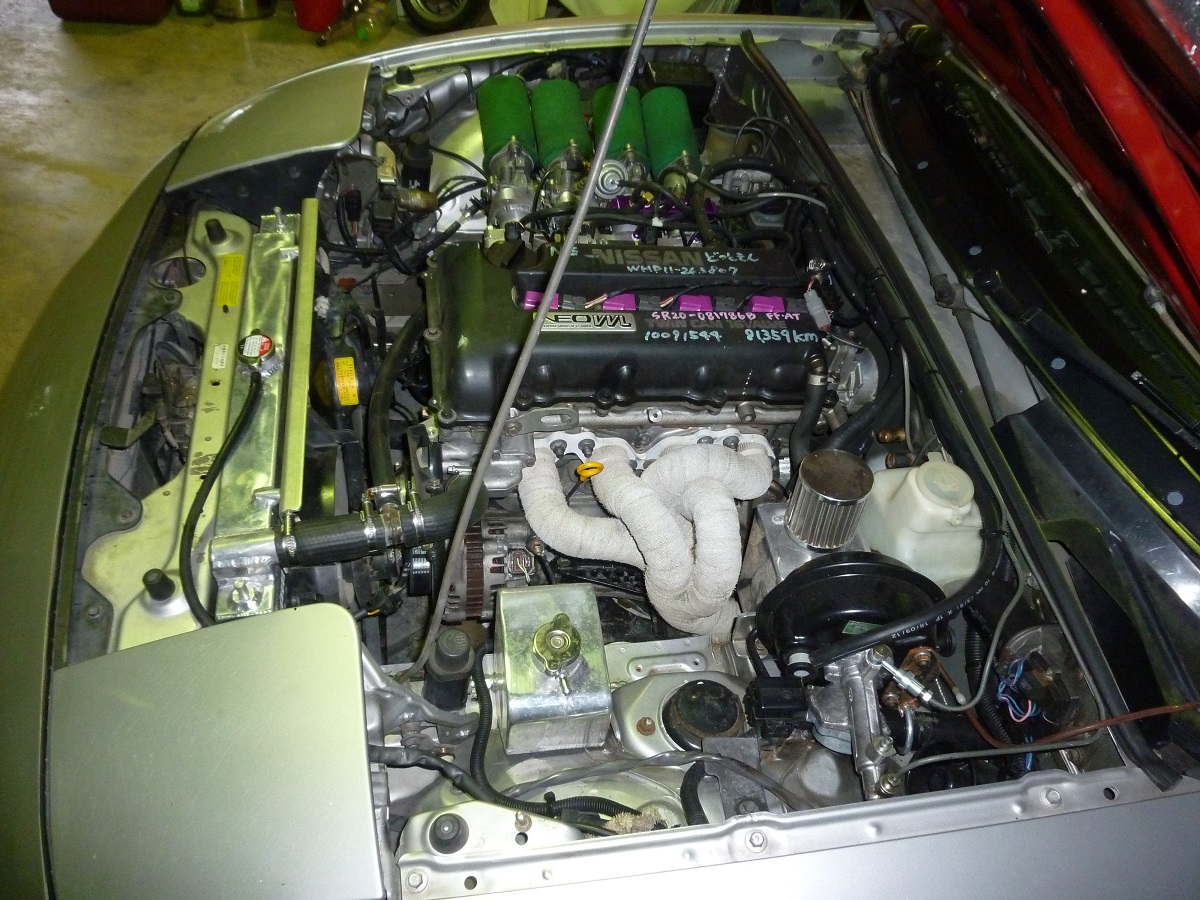

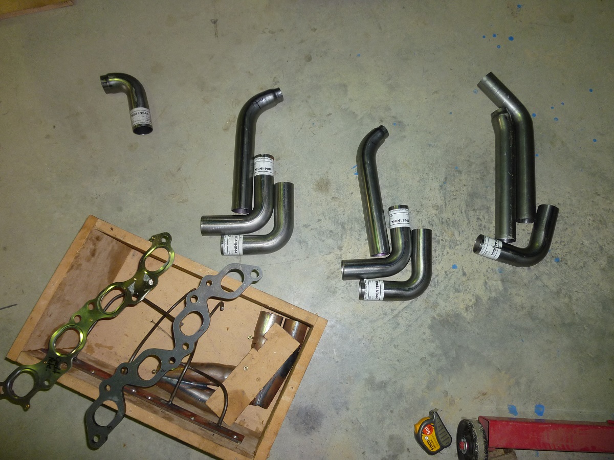

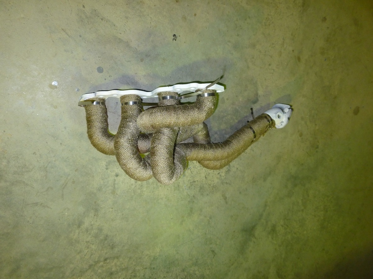

Spent last winter on a repower project for the MX. Decided to go with an SR20ve due to the stock 180hp and huge aftermarket support. Not to mention the ali block for a bit of weight saving. Did all the fabrication in my shed and had someone else do the aluminium welding for me. One of the biggest jobs was the header construction, close to 40 hours there.

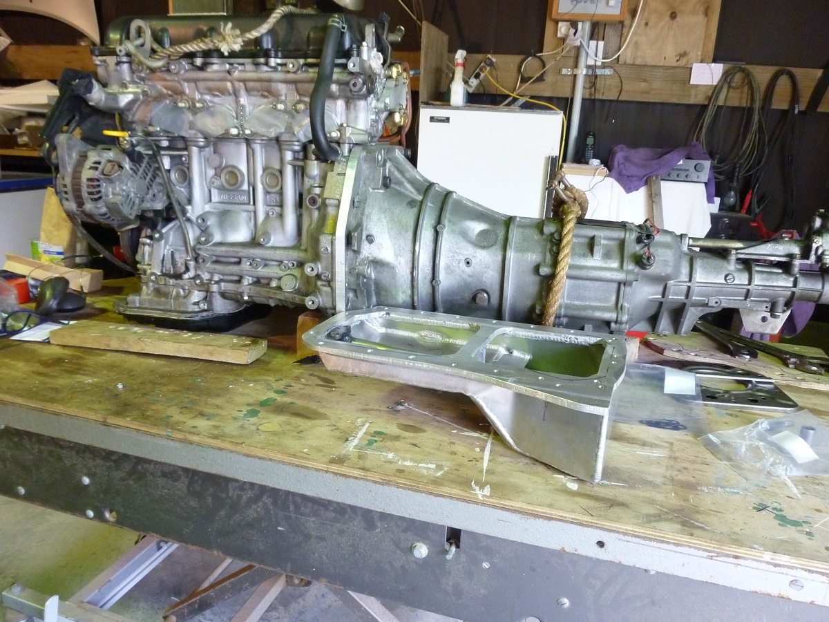

I made an adaptor plate and bolted the plate to the engine then the gearbox to the plate. The flywheel is a bit of a freak in that I used the MX5 one with the ring gear removed and machined down to just enough to bolt the clutch to. I kept the Nissan ring gear and made a boss which bolts to the crank and carries the flywheel.
Had to make a rear sump and pick up to avoid chopping any chassis etc.

Very awesome!

Yea I'm happy as with the result, describing what I did to get here is hard but the picture spells it out.

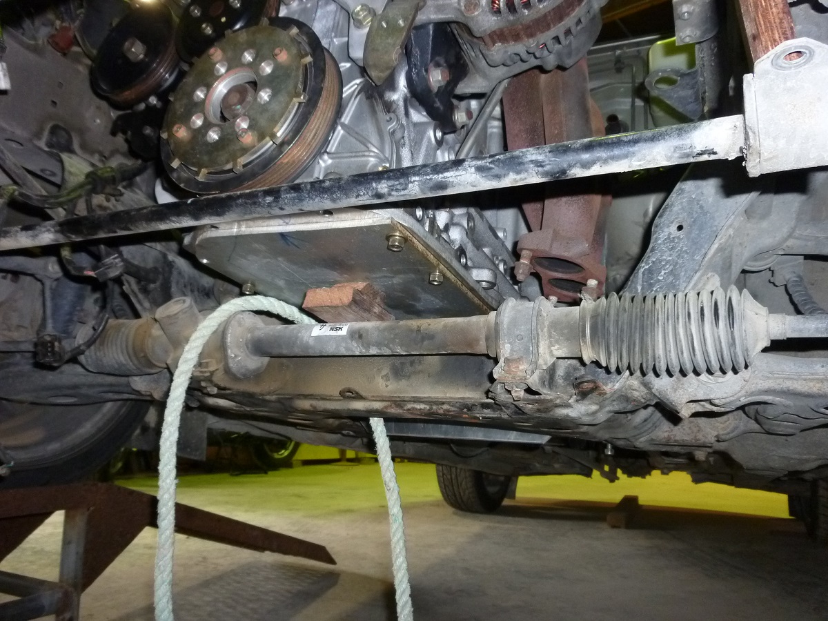

OK, here's an early one with just a plate bolted over the bottom of the block so I could have a look at what had to happen here for it all to fit.

Here's the SR bolted up to the MX5 gearbox showing the adaptor plate and the new rear sump in the foreground.
