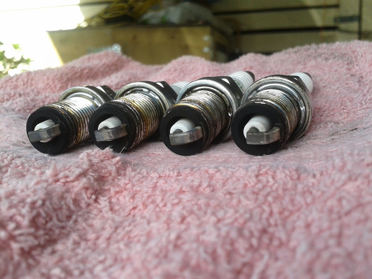

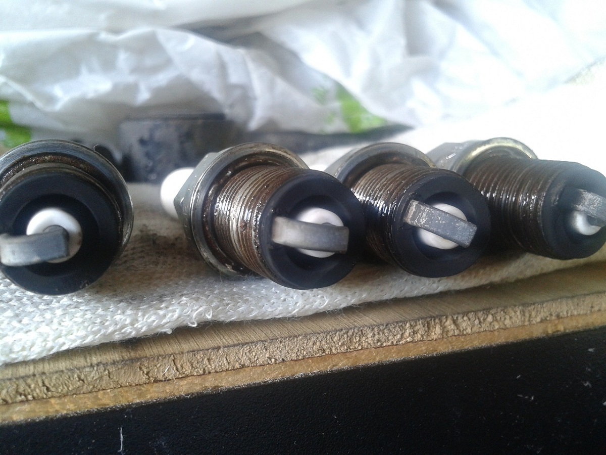

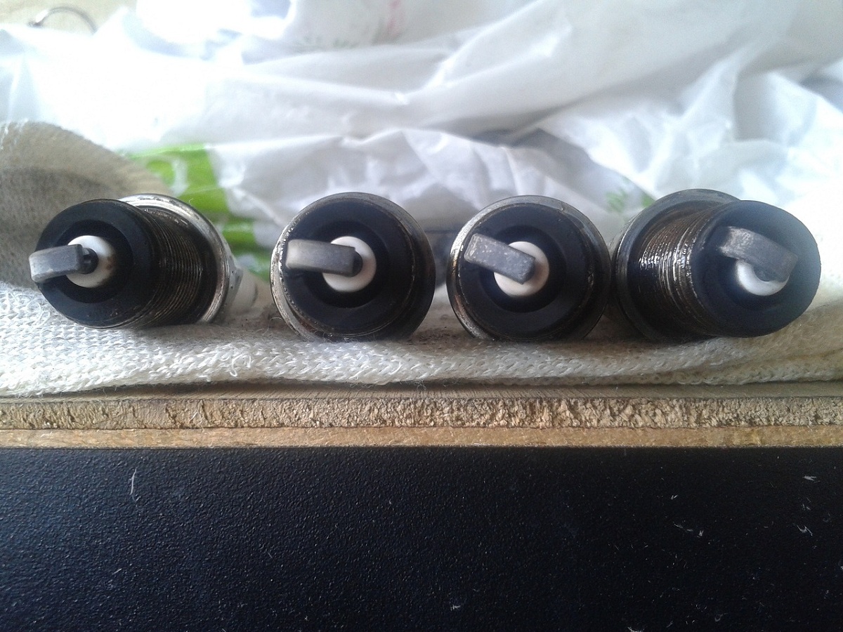

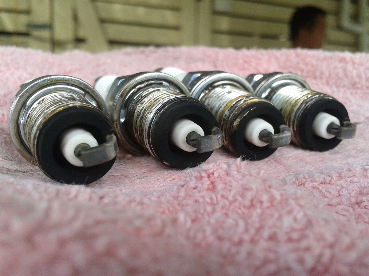

Pulled out my spark plugs to check them after my mechanic friend mentioned the car felt like it was running lean.
I put these in new around 1648 kms ago around the same time I did a Timing Belt job. I have a suspicion that my timing belt might be a bit off. Opinions?
From Left to Right: 1 2 3 4
1 2 3 4
1 2 3 4

It's got a slight hesitation and a fair amount of vibration on quick, small blips of the throttle from idle if that's what you mean but no misfire that I can hear.
@WOT
Cheers for the link! After reading through it, it seems I've got too much timing (#4 is the best indicator with the others not even having a colour change on the ground strap). And what might be evidence of detonation on #1.
@Snapfrozen
No it's not oil; just some antiseize that I put on there (might have put a bit too much looking at it now).
I'll be redoing the belt tomorrow and probably put some fresh plugs in to do another check after it's done.

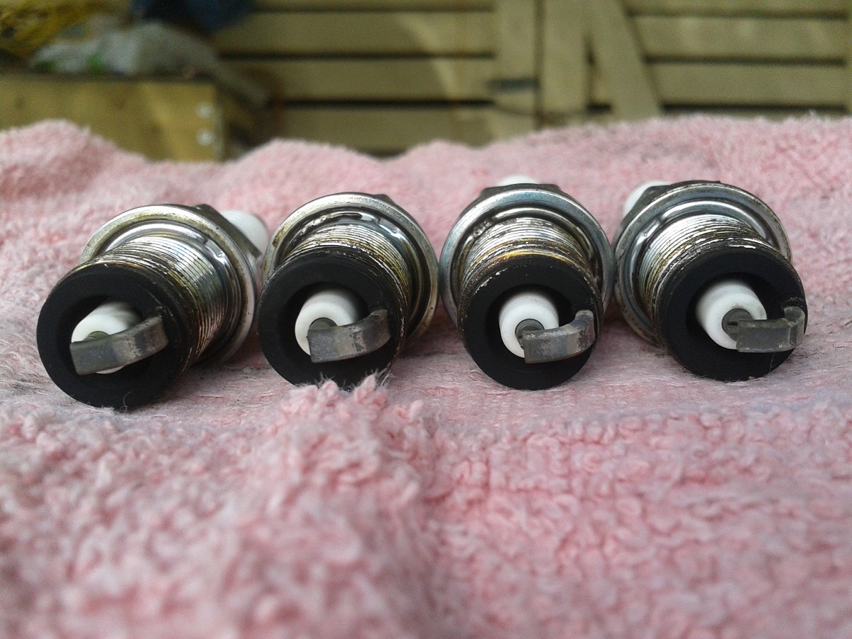

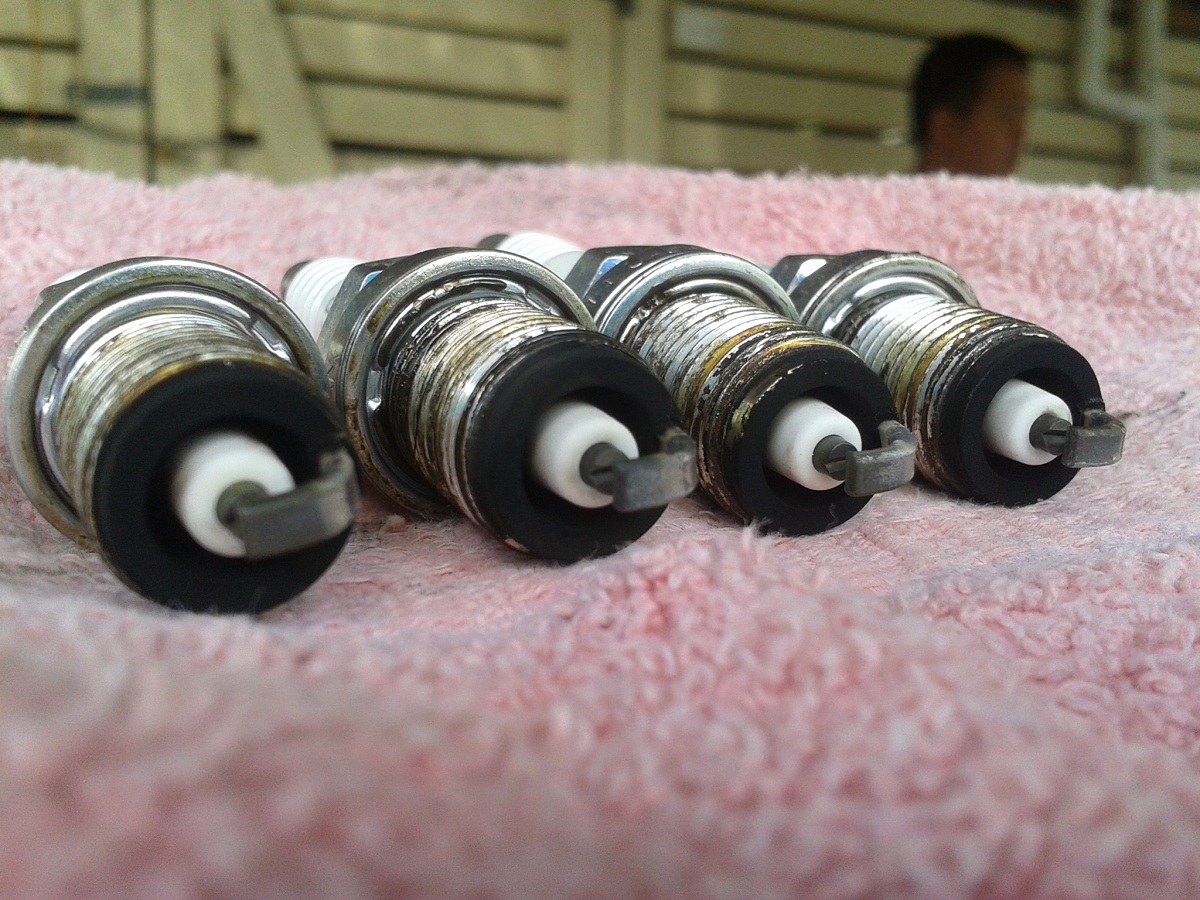

Post by SkilletKid » Fri Apr 18, 2014 12:46 pm
This is after 1307km of driving;
From Left to Right is 4-3-2-1

Post by Teamjelly » Fri Apr 18, 2014 4:52 pm
I wouldn't worry about those plugs too much
There's no sign of detonation
The BKR7E plugs used to look exactly like that in my Turbo NB, to the point I was running the full load mixture at 11.0:1 and the high boost timing at only 11' BTDC to see if that would help
It didn't.....
I solved it by fitting a set of NGK V-Power 9 Racing plugs, Part number R5671A-9
And straightaway with no alterations to the tuning, the plugs are always a beautiful light Tan colour. I can run the timing quite a bit more advanced than before with zero detonation, which has increased the power quite a bit too.
I think the plugs were just running a bit hot and burning off any deposits. :)

NGK BKR6E11; gap was 1.1.
I set the timing to 10deg after I switched to these fresh ones since the last time I took a picture. Just find it a bit weird that the porcelain is that clean near the tip. And mind you Jelly, this is without a turbo haha.
Edit: And it seems odd that the ground strap is that clean considering the stock ECU is known for running quite rich.
