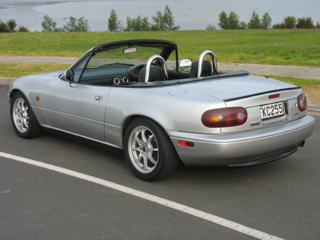

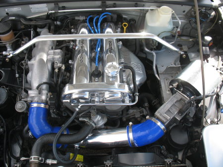

First a couple of pictures of the car it is going onto. It is a 1991 1.6 NA. The engine is standard with only good oil, good plugs and a home made air intake. I have a cold air inlet from the headlight which will stay. The car goes well but I want more POWER!
I would like another 50hp which should be easy enough.

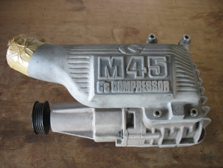

Here are some pics of the parts I have so far. I know I have got a long way to go but thought I would put as much as possible on here to help anyone else out that might like to do the same. Any questions please ask and any help you can give I would welcome it.

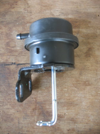

The 1st picture of the bypass valve I bought from Moss motors...I will be getting about half of the items from them and about half from trackdog racing. Why the difrent suppliers? its just a price thing as they have quite varing prices.
