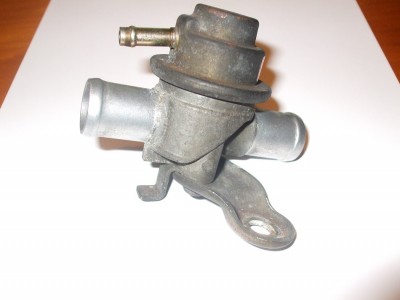

G'Day.........any body recognize this part? It came off my 323 & it looks like blow-off/boost controller.
Cant seem to find it on the Denso site.
I might whack it on if it is!

Well just for fun i connected it up to the intake track just before the throttle body plus the smaller tube to vacuum behind the TB.....i vented it to atmosphere & found the larger pipe to have a slight vacuum which also dropped engine revs slightly but returned to normal if i blocked the end.
I am thinking that it may need to be installed in closed loop somehow & by the looks of the internals it might only go one way?

HahahaWideOpenThrottle wrote:Well just for fun i connected it up to the intake track just before the throttle body plus the smaller tube to vacuum behind the TB.....i vented it to atmosphere & found the larger pipe to have a slight vacuum which also dropped engine revs slightly but returned to normal if i blocked the end.
This is because the intake manifold is giving a vacuum signal to the valve which opens it at idle, the revs are dropping because you have made an air leak in the system
If the air were recirculated this won't happen as the air stays in the intake sytem after the MAF sensor has calculated it.

It depends on the intake manifold pressure you are running.WideOpenThrottle wrote:Cheers Hab
So could this device be beneficial or a waste of time do you think?
wot
If over 12-13psi I would use something. You will benefit from better throttle response and boost rise after gear shift
