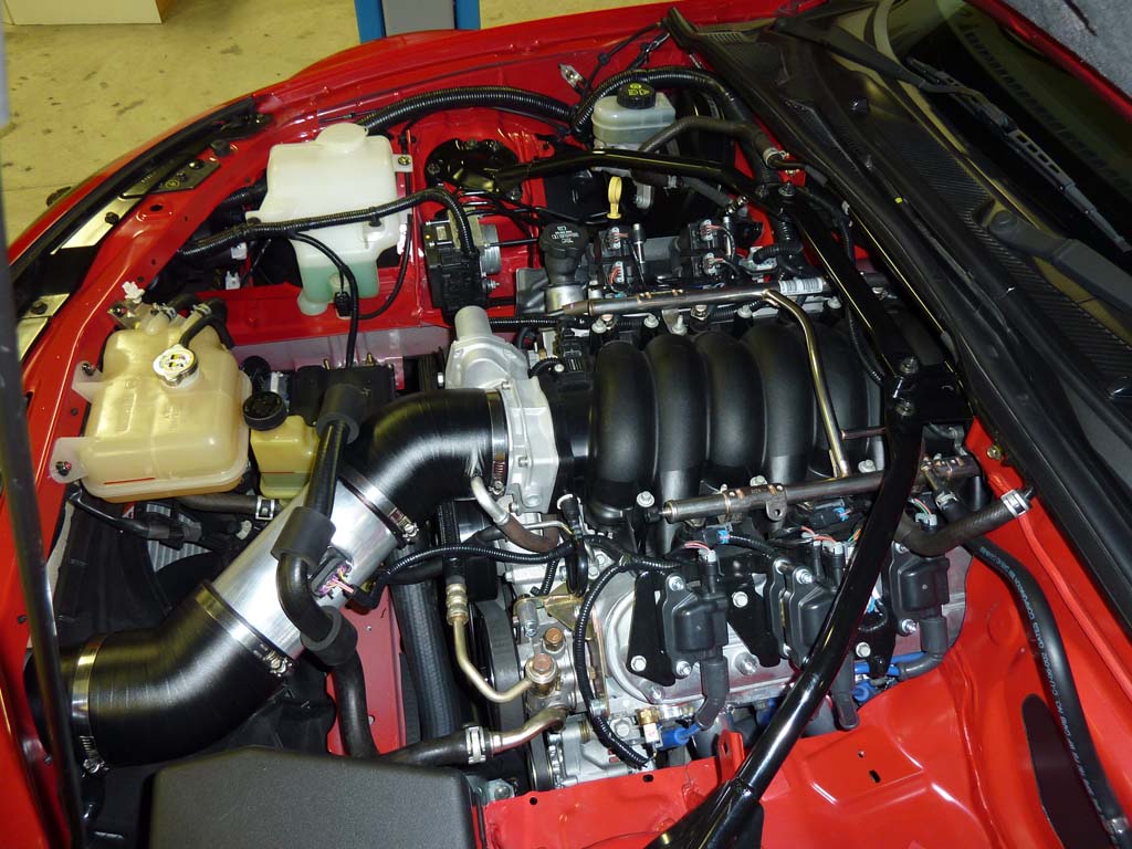

Car has lost- (Yes Lost!) weight on front axle, I've had to lower the front by 20mm to restore standard ride height.
This is first NC conversion in the World- Boss Frog Kit is for NA/NB
Gearbox is Tremac T56, GM front half to suit engine and AC Cobra tailshaft housing. The GM (Holden) tailshaft is way too long and results in hopeless gear lever location.
Gear shifter is loosly based on Ford Mustang but modified to my own design to allow use of standard internal console trims.
Sump is Holden, but reduced in depth by about 22mm and internal baffles and oil pick-up redesigned to suit. Still holds 7 litres including filter.
Headers built to suit and ceramic coated inside and out to reduce heat build up.
Diff is standard
with Redline "Heavy" gear oil, has done 10,500 kilometres so far, including a track session at Taupo- no noises or leaks (yet).
I 'm sure if the car was raced regularly a stronger diff would be required, but at the moment it's just a road car.
I wouldn't use ford thunderbird diff- I'd use RX8 with FD crownwheel and pinion, because the design and mountings are identical to series III MX5; but for me the "factory" look is more important than ultimate strength. Once again- this is not intended to be a race car...

440HP 6.2L V8 2005 NC
