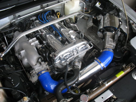

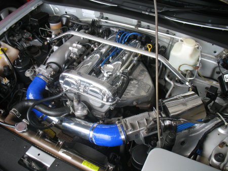

Post by warrior » Mon Oct 18, 2010 7:58 pm
I have finished the intake pipe and am running it on its side and its runs perfect...just in case anyone wanted to know.

Post by warrior » Wed Oct 20, 2010 5:34 pm
sorry new to this....how do I insert some pictures of the intake pipe on here? Any help would be great :oops:
Post by warrior » Wed Oct 20, 2010 5:40 pm
here we go
