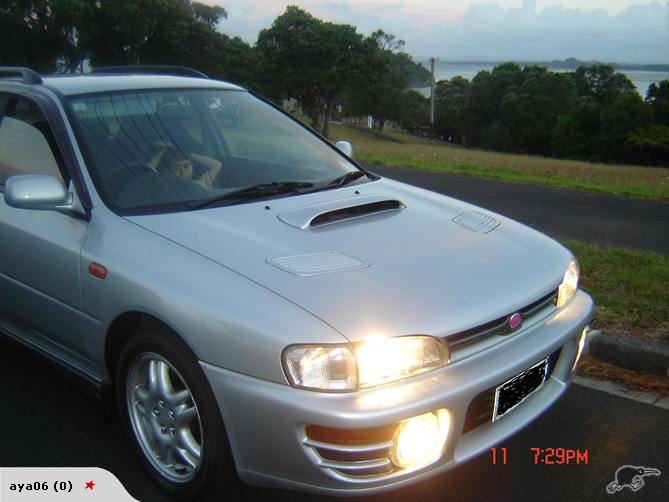

I have just got a couple of small bonnet vents from a WRX that I am “thinking” of putting in the mid-upper sides of the bonnet (a little further back than they would be on a WRX – see pic below – or I could even move them right forward). Does anyone know if this would in-fact allow air in or out of the bonnet? I ask this as I don’t want additional engine fumes while toodling along. There was an MX5 NA bonnet in black I think on TradeMe recently with these WRX grills in it, and they looked good, quite subtle.

The bonnet vents seem like a good idea, tho I haven't done that. Still procrastinating on that one!

I think you will find that the above Mazda ones are designed for low pressure extract... the Subaru one will be intake as I presume the intercoolers are on top. These Mazda ones were always to quickly extract air flowing though the front mounted radiators/intercoolers.poison wrote:Some people also claim this to be a ‘low pressure’ zone so very little air gets taken in (I don’t agree) but don’t actually know.
I believe there have been a number of people that have measured the bonnet areas on the MX5 and they all found higher pressures at the base of the windshield (good for cowl mounted intakes) and lower pressures across the bonnet (good for extracting hot air). Sorry - can't find any actual www evidence for you at the mo though...
