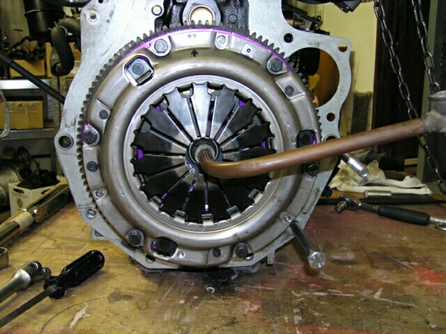

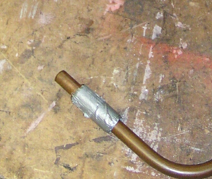

An even easier way, if you have any, is a piece of 15mm ID copper water pipe and then wind layers of a heavy duty cloth tape around it to pack it out to the inside diameter of the clutch plate spline. Its all I used and it worked fine. Will post a photo when I get home.
- Posts: 619
- Location: North Shore
Sorry, been a bit busy. Targa is approaching fast.
Pipe was actually 15mm outside diameter and the tape was packed out to a diameter of about 22mm. It needs to be a reasonably snug fit inside the spline of the clutch plate.
The end portion needs to be long enough to fit well inside the pilot bearing so that it does not move too much to ensure a good alignment.
