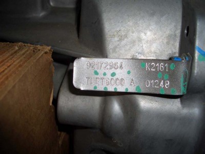

I imported a new gearbox from Holden Australia, the Cobra and Mustang parts to modify it came from the States.
The Engine Management system and Brakes are from the States, but both required a fair bit of modification to fit MX5.
