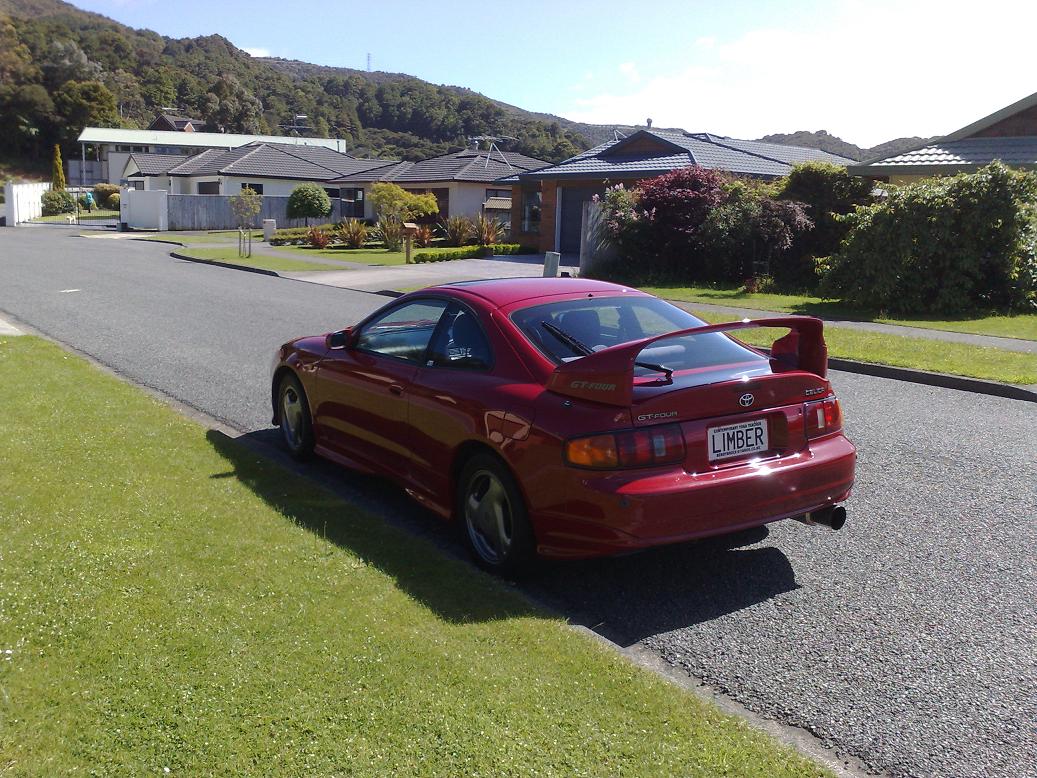

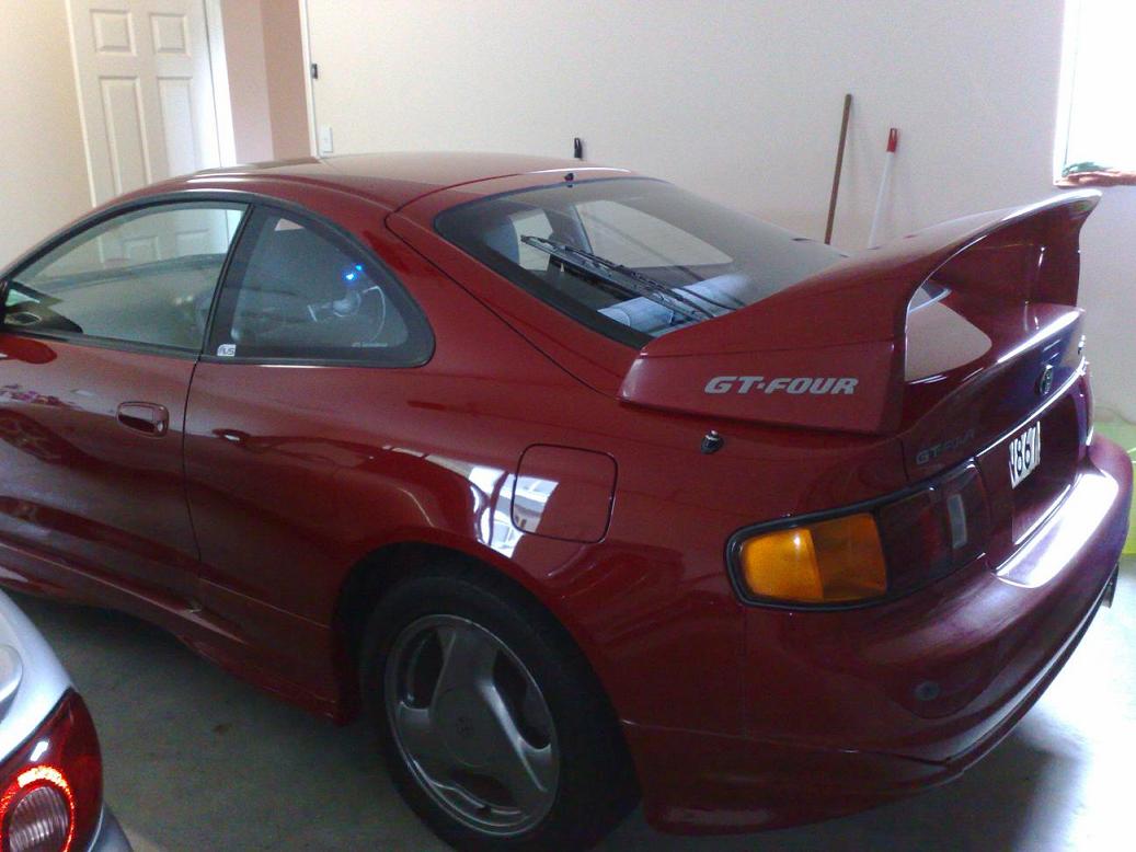

Post by Quidam » Tue Nov 17, 2009 5:32 pm
ps. here's a quick pic I just took of it.
It's in amazing condition for its age and milage, only thing I don't like are the stock mags UGLY

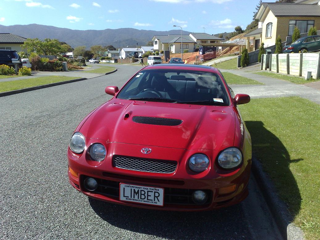

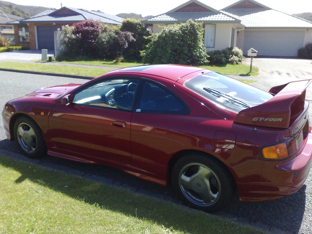

Sunny day + day off = more pics of my latest toy :P
New 18 inch mags going on tomorrow!
