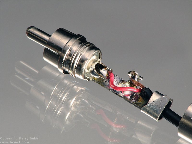

an RCA plug is simply just a style of plug and you would have no hassles wiring them together.... just get a pair of female RCA plugs from dick smith and unleash a little soldering skill... the positive signal goes to the center and the negative (earth) solders onto the outer sleeve bit.
this pic shows how it should look like after soldering.
any more questions just ask
