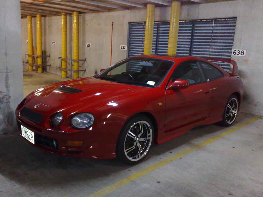

Post by Quidam » Sat Nov 28, 2009 8:13 am
Pic of my GT4 with the new 18inch Konig Unkowns :o
A complete transformation compared to the 16 inch stock mags. Also makes the ride a little more firm, but still feels soft compared to my MX5, which literally rattles my teeth! (the Mazdaspeed Miata has even stiffer suspension than the regular MX5, which to be honest I think is overkill -you would never buy this car for the comfortable ride)
