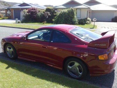

So I've bought a Jap Import 94 Celica GT4. Very well looked after by 2 previous owners in NZ, with the 1st owner being a Toyota Employee (40% discount on all his receipts). 2nd owner has just had the cam belt and clutch done.
So I just assumed high Octane petrol is always the best choice, but it occurs to me that if a is car is imported from Japan then maybe it's tuned to run on lower octane fuel? Am I wasting my money putting more expensive gas in this car?
Thoughts/advise appreciated.
