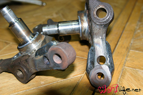

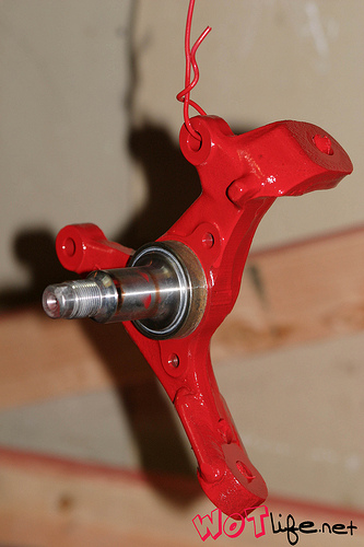

Post by Kieran » Tue Apr 10, 2012 4:41 pm
Ive heard they are good but you can modify the steering knuckles for more angle aswell
Check this out
http://clubroadster.net/vb_forum/showth ... t=knuckles
Before
After

Post by Kieran » Wed Apr 11, 2012 11:02 am
why cant modded knuckles get a WOF they wouldnt even know the difference
the WOF guys dont know shit if you didnt get them painted they will look stock
These knuckles have also been impact tested
Unpainted
Painted

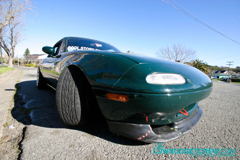

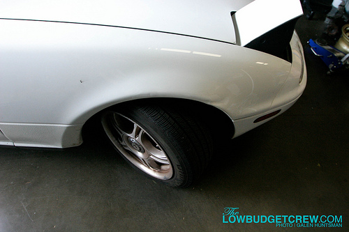

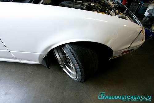

Post by Kieran » Wed Apr 11, 2012 2:00 pm
lets put it this way I heard with the modded knuckles you can do a U-turn in the space of 2 car parks
Look at the earlier pics I put up the wheel has a better turning circle sensitivity doesnt change unless you depower the power steering rack
in the pics it doesnt look like alot but thats a good +20-25 degrees steering angle
Post by Kieran » Wed Apr 11, 2012 2:06 pm
heres some better pics with JUST modded knuckles no further steering mods
Post by SLYDIT » Wed Apr 11, 2012 10:47 pm
can you buy shortened kuckles? not keen on welded ones.
Post by Kieran » Thu Apr 12, 2012 9:46 am
they are all just welded unfortunately there is no manufacturer that just makes them
