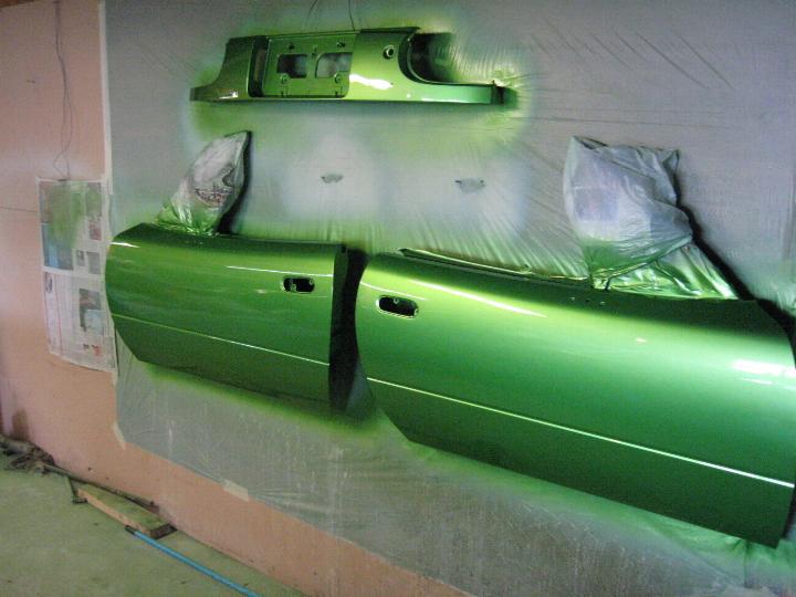

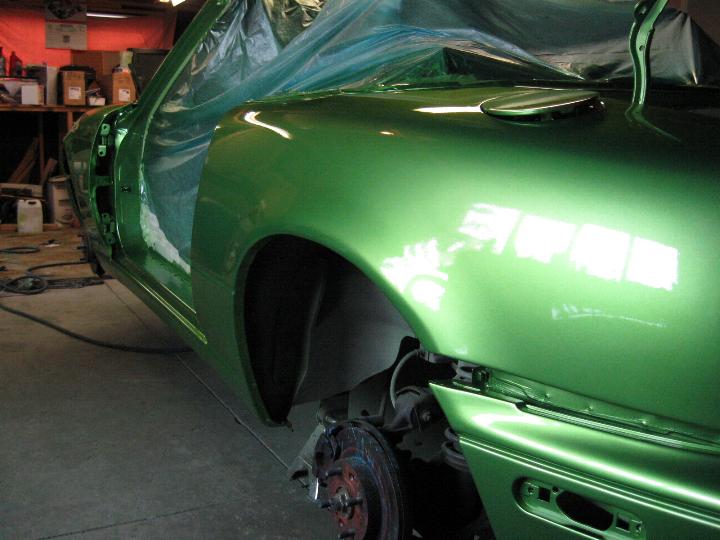

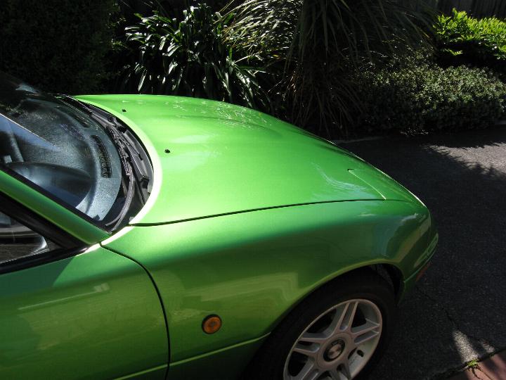

Post by JasonZE » Wed Feb 29, 2012 5:10 pm
took the day off and finished up the green and layed a few coats of clear down and off the gun im amazed how flat i got it I though i would be blocking out orange peel for a day or so!
Letting it harden for a day then clear the underside of boot/bonnet and inside of doors which are all painted just not cleared yet then assemble at the weekend and snap some finished pics,

Post by JasonZE » Thu Mar 01, 2012 6:24 pm
Thanks guys Im happy with how its going so far.
To keep the dust down is hard I just swept and hosed the garage out between processes and have a couple of ol fans by the side door blowing some of the overspray out nothing fancy.
I use my gravity feed gun to paint it its only a basic gun i got a few years back for around $100 and borrowed a mates compressor.
I think using good quality (expensive as hell) products and not skipping any processes aong the way contributed to the good result.
