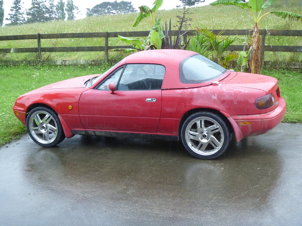

Got my hands on a set of 17" rims from someone who used them on his race car, and wrapped them in sticky Toyo R888 205/40 rubber. Think I should have gone 16", but at the time of the purchase had the full intent of putting a set of 4pots Wilwoods with 310mm rotors in there. How things change when you do some digging around. Supposedly the Yanks are running up to 255's on the back of their cars without a widebody kit, and just rolling the inside of the guard, with a different offset wheel.

Notice the 4x4 ride height now, time to consider suspension. I would just like to add that if that whatever plonker stuck the wheel nuts on the orginal set of wheels must have had the torque setting on his (or it could have been her's) air gun wound up to full noise, and laughing their arse off think of the next poor sod that would have to remove them (being me). Managed to snap on of those cross type wheel spanners at the weld trying to get the bloody front nuts off. First part of swearing involved in the project, and all I was doind was changing the wheels.
The other little problem experience going to the larger wheel and tyre package was the increase of weight over the little 14" wheels, a massive 5kg each wheel. So much for being light weight rims, but I guess that's what happens with more mass involved.

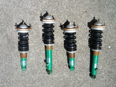

Start of a new year, and time to play around with the car. had previously purchased a set of Tein adjustable coilovers from Mark at Mazline in CHCH (hope you guys are all back on your feet again now) and decided it was time to shove those in, along with the Roll over bar that I got from Don at Autoways in Hamilton.

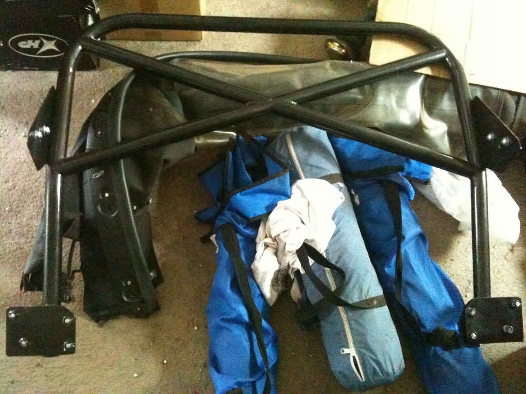

Started with the Rollover bar first, cause thought that would be the simplest job, wrong!. Especially when you don't have the right tools. The drill and drill bit that I had, just weren't up to the task, and after about 20mins of trying to drill 1 simple hole, gave up in disgust and headed to the hardware store. Any excuse to buy more tools. Got a new drill and a stepper drill bit. The drill bit was just about worth as much as the drill, but man, did it make life simple. Drilled 4 holes in half the time it took not to drill 1. So half the day gone, and only have just got the roll bar in, more swearing and cursing involved.
Also, once the seats went back in, noticed a small design flaw in the roll over bar, and that the cross over pieces stop the seats from going right back. Ok for me, as I am a shorty, but not going to be so good for anyone with lanky legs. May have to address in the future.

So with armed with new tyres and suspension, and after having a quick chat to the local Tein supplier about how to make adjustments, headed down to Hampton to do some testing and some fiddling around with settings.
It is here that I learnt that the early MX5's weren't exactly designed to go around a track more than 2 or 3 times, and it started overheating, problem apparently to do with the massive gap at the top just in front of the radiator, which meant when push come to shove, most of the air was taking the quickest route and going straight over the top of the radiator, this was discovered after a quick chat to some of the other guys running MX5's there on the day, and them having been thru the same pain. So testing was limited. What I did discover is that with the damper setting set to it's firmest both on the front and rear, the car was damn near impossible to drive, and just bounced all over the place. And this was on a racetrack!!. God only when people would use this setting, certainly not on the road. Time was about the 1min 30's when not cooking itself and top speed a miserly 145kph. Don't know how accurate that is, as just took it off a GPS tracking software on my phone.

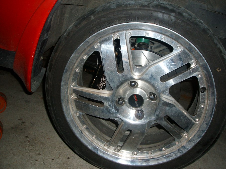

All of you that have been following my post will recollect, the idea was to run with a set of 4pot Willwoods on a 310mm Rotor. When I started poking around and getting pricing together, it was turning out to be rather expensive. The most expensive part of the whole process was the making up of the aluminum hats for the rotors, and cost where coming in at about $2.5K plus GST. So hit the net again, to see what our friends over in the good old USA had about the place. And what do you know, I could buy a set of 6Pot Willwoods, 280mm front rotors, 270mm rear rotors, steel braided lines front and rear and brake pad front and rear for pretty much the same price as what it was going to cost me just for the 4pots and rotors in NZ. So scratched my head for a while about whether the downsize in rotor size was going to be compensated by the 6pots, and decided to go for it. A lot of this price comparison came down to the fact that the NZ was up to 80c against the US at the time ($1990USD for the 6 pot kit)
Brakes were supplied by Goodwin racing, and a full set of instructions were supplied that an idiot could follow, which is good, because an idiot was fitting them (me). Got them on, drained the brake system, well that had been done removing the old calipers, and filled it back up with hi-temp synthetic Dot4 fluid (you will notice the mess I made from the photos, that's cause I didn't have a bleed hose at the time, but I do now). Bleed the brakes and had a problem with the LHS front caliper just leaking a little bit under pressure, from the connection of the braided line to the caliper. Ended up pulling that side out, and trying to figure out what was going on, ended up just tightening the crap out of it, and that sorted it. Put the wheels on, spun them, and then heard a lovely grinding noise. The splash guard on the front brakes were scraping up against the back of the rotor (no problem on the back rotors, as I had to cut the guard away). So take the wheels off the front again, and make some careful adjustments with a knockometer (smack the crap out of it with a hammer). Put it back together, spin, quiet, good. Spin, turn steering wheel, grinding sound, more swearing, take wheels off, adjust braided lines. These things don't seem to flex as much out of the way as the old rubber ones, so a bit more care and thought is needed when tightening them up as to where they are going to go when the wheel is turned from lock to lock.
Right, this time, spin, turn steering wheel, quiet, good. Drop the car back to the ground, take it for a short spin, all good, but a bit spongy on the pedal. Bleed the system one more time to get all the air out, and go for another blast, and man oh man, what a difference. Nice firm hard pedal with lots of feel.
Now the fun part, beed the pads in. Find a deserted piece of road, and thrash the brakes. Slowly and gently at first, and then hard and fast towards the end, until the whole thing is stinky and hot (inset crude joke here, cause I know you are all thinking it). Take car back home slowly and quietly to let the system cool down, and park up in the garage with the hand brake off.
One thing that did happen, was the rears where locking up under the real hard braking, I assume due to that fact I had the front and rear suspension set to the softest damper setting, and the front were grabbing big time, making the nose dive, and shifting the weight balance right forward, and making the rear nice and light. Have made some adjustments to the suspension since then to stiffen up the front slightly, but haven't had a chance to test out since then.
