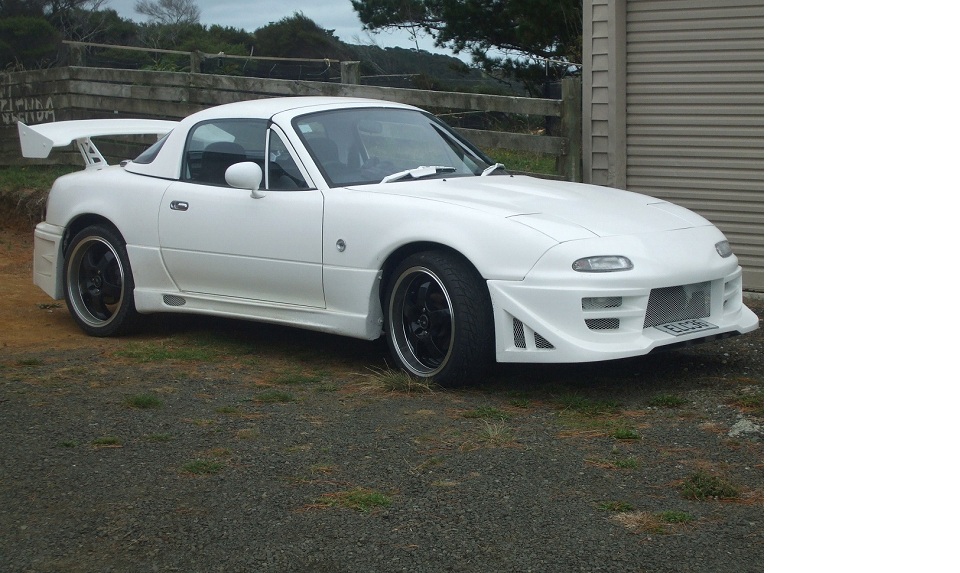

Hi MR Shine-i have removed the soft-top & air-con,no power steer pump & hoses,auto to manual window winders[easy],no tow brackets,no air filter housings, no carpet underlay,no front or rear bumper plus several other engine bay & boot plates & brackets, no exhaust or cat no wheels & most importantly no dirt :D .
This was to make way for new paint, turbo,intercooler, pod filter, tuned manifold & exhaust,body kit,boot spoiler,15 & 17 inch mags so one day i will weigh it again as i know its original weight!
Still to get a racing seat, bigger brakes & lowered suspension plus engine management.I did have only one fan for a while but now i have it in series with the other for that extra cooling.
