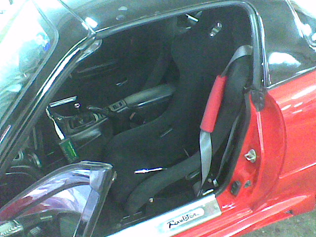

Post by sprsta » Fri Feb 26, 2010 7:18 pm
i just brought a set off trademe for 200
drivers side bolted directly to the factory rails no problems
passenger was on a lean to the left for some reason but moving the mounting points on the left up one hole worked fine
im very happy missus not so
(f!@#n bucket seats)

Post by Gravelben » Tue Mar 02, 2010 5:22 pm
Those look good, what brand/model are they? and how well does the seatbelt work with the deeper bucket?
