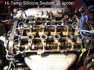

When renewing the valve cover gasket you will need to use some type of oil resistant silicon sealant.
I recommend Three Bond 1215 grey gasket sealant. I use this on all engine and gearbox parts.
Also when you have the cover off, please look closely at the cambelt area to see if it has oil on or around it.
If it has, check the camshaft seals that are on the front of the engine behind the two top pulleys. If this is wet with oil the front engine seals will need renewal also.
Have a look at the picture attached for the points to apply the sealant.
Gannbare
